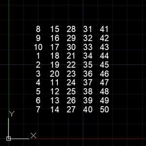

1. Create a random matrix of text using the array command.
2. Explode (the array) and run a TCOUNT. Select X-axis order. This happens!
3. Why on earth!
I tried your method but ended up with a different sequence. lol.
It looks like if you give it X order it will count from left to right (obviously) but if you line them all up on the Y axis it gets confused I guess?
I did try this by first selecting each column independently, (left to right, from top to bottom), before running TCOUNT.
It then seemed to work fine using "select-order" option, overwrite.
It does seem that if you tell it to count along Y axis, the numbers make more sense.
Why would you not ignore array and just create the text via columns or rows then its in correct creation order. or number as created.
