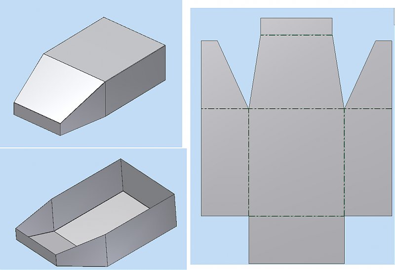

Hi group,
I a have a solid shell, I have created it using the Shell command in a 3D Solid. I need to know if is possible to convert that shell in a sheet metal, to unfold it and then cut in a laser cnc machine.

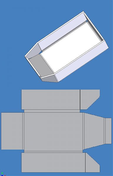

This part (As far as I can tell from the pics) does not have any corner radii and all your edges intersect. So the simple answer is no. You cannot unfold this part. You could unfold this part after a lot of time is spent making gaps in your corners and adding radii but it would be simpler to redraw it in the Sheetmetal environment with the sheetmetal tools. You could probably do this part start to finish in about 2-3 hours if you have read the tutorials and have an idea of how to use the sheetmetal tools properly. As opposed to trying to fix what you have taking many hours to complete and having a really screwed up model to fix when changes need to be made.
2-3hrs? i just drew this in 5 mins. To get the shape accurate you would need to use some sketches, i did this with all flanges and cuts.

inventor 10 my friend:) Seriously though Sheetmetal is very easy to use. If you want to spend a lot of time and work on corner reliefs and getting really tight edges it will take a bit longer. It all depends on the end product. I have a big hammer and can weld gaps ;)

Actually the original could be fixed up pretty quickly through the use of Derived Component Body as Work Surface and a bit of knowledge. But of course the OP might as well learn sheet metal tools.
Attached my first attempt.
Actually, I was giving a conservative estimate of how long it would take someone with little to no experience using the sheetmetal tools. Shift's example is about what I would expect someone's first attempt to look like. It would then take a while longer to figure out exactly what the reliefs and corners should look like to get a manufacturable part that meets the criteria of the OP's original design.
I could have thrown something together in less than an hour that most likely would have been acceptable but I was trying to make no assumptions of the OP's skill level.
I can see that. I had a guy who has never used any cad software before start with inventor sheetmetal and it took him about 6 hrs to get a usable drawing with a little instruction.
I wasnt trying to say anything about the poster so i hope it didnt come off that way. I was only trying to show it takes very little time to get a rough part in front of you. The knowledge needs to be gained first through use of educational aids. I would never turn that drawing i posted into a part :D
