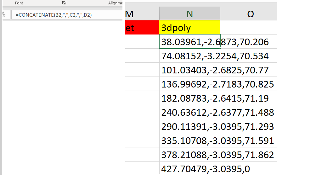

If you think of it as X,Y,Z then no code required in cell N1 type 3dpoly, in cell N2 put this =CONCATENATE(B2,",",C2,",",D2) and copy down for all values. You should see as per image that x,y,z values have been made.
You then select column N starting at N1 and going down to last entry add 1 last blank line. For test xls this was N65
Use Copy or ctrl+c to copy the selection, go to Autocad click on command line and paste or ctrl+v
A 3dpolyline should now appear.

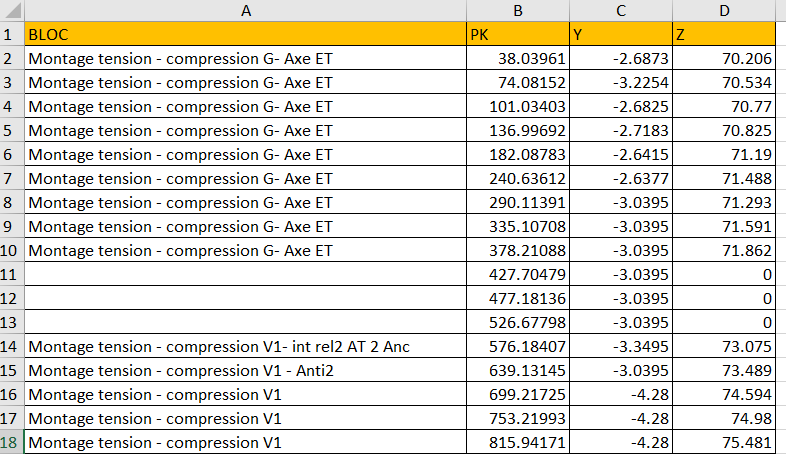

I want to insert the blocks, following a polyline, for that, I put the autocad file and the excel file, as an example. These blocks were inserted according to the excel file (PK, Y), but the concern is that I do not have the associated lisp.
In the Excel file, the BLOCK column is the name of the autocad block, Pk is the chaining of the polyline and Y is the position of the block relative to the polyline.

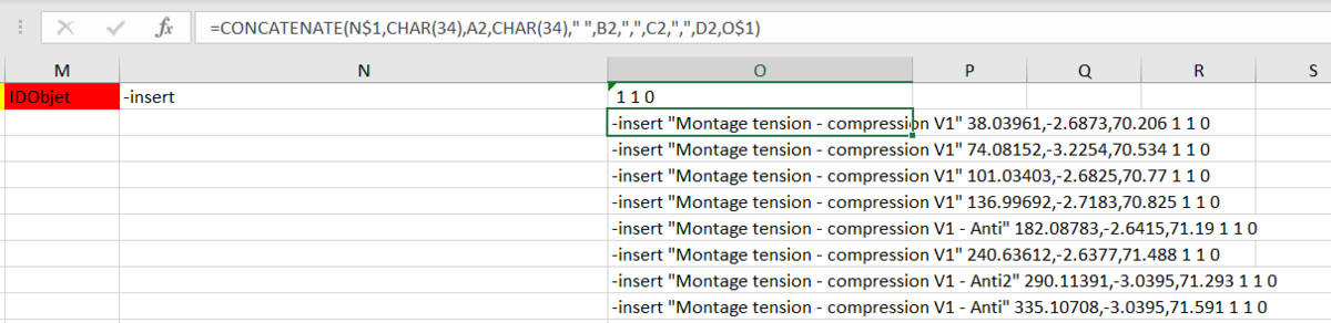

ok, and after doing the formula in excel, how do you give this info in autocad?
I just made the formula, and this marks me as an error

The other way is to copy the columns together to a new worksheet and save a CSV file which can be read in a Lisp program this is probably a easier way to go..
BLOC,PK,Y,Z,,,,,,,,
Montage tension - compression G- Axe ET,38.03961,-2.6873,70.206,,,,,,,,
Montage tension - compression G- Axe ET,74.08152,-3.2254,70.534,,,,,,,,
Montage tension - compression G- Axe ET,101.03403,-2.6825,70.77,,,,,,,,
,427.70479,-3.0395,0,,,,,,,,
,477.18136,-3.0395,0,,,,,,,,
,526.67798,-3.0395,0,,,,,,,,
Montage tension - compression V1- int rel2 AT 2 Anc,576.18407,-3.3495,73.075,,,,,,,,
Montage tension - compression V1 - Anti2,639.13145,-3.0395,73.489,,,,,,,,

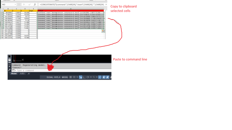

how do we insert these points in autocad ??
Edited by Nowak
I make the copy paste, but autocad put me unknown command "0",
yet I have the block insert in the autocad drawing
Edited by Nowak
when wanting to insert the block, in script version or by excel, autocad considers that it is a command and not the name of the block

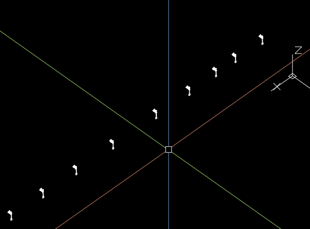

Make sure the block exists in a blank dwg else it will work but will be to far away to see in a current dwg.
I tested again
paste to command line
Zoom E
-vpoint 1,1,1
