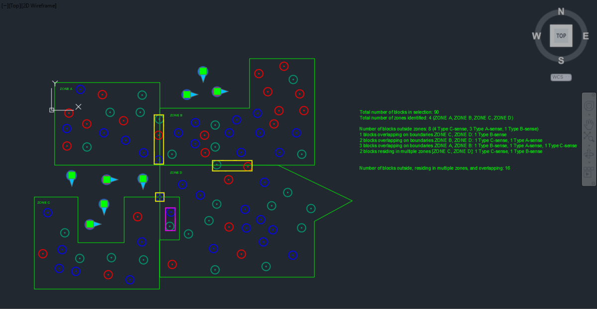

Highlight & count blocks not inside polylines
Skierz
9 minutes ago, Skierz said:
Thanks for highlighting the issue @Jonathan Handojo.I didn't realize that I just wanted the polyline borders to be bolder in many cases that's why I thought of increasing the width.
Can you suggest any other alternative ?
Also,  there is one more thing I want to request that the objects on locked layers should not be selected .Can we include such check ?
ssget F will only catch selections that are visible on the screen, which is why I added:
(vla-ZoomWindow acadobj
            (vla-GetBoundingBox vx 'minpt 'maxpt)
            minpt
          maxpt
to zoom into each selected polyline temporarily, do the selection, and close it with:
(vla-ZoomPrevious acadobj)
Because it happened so fast, it didn't seem like your screen zoomed at all and stayed as is.
Since your polyline is so many times a lot bigger than a very thin "on-screen" thickness, it shouldn't pose a problem for you.
For a locked layer, at the very start of the code:
(ssget "_:L" '((0 . "INSERT,*POLYLINE")))

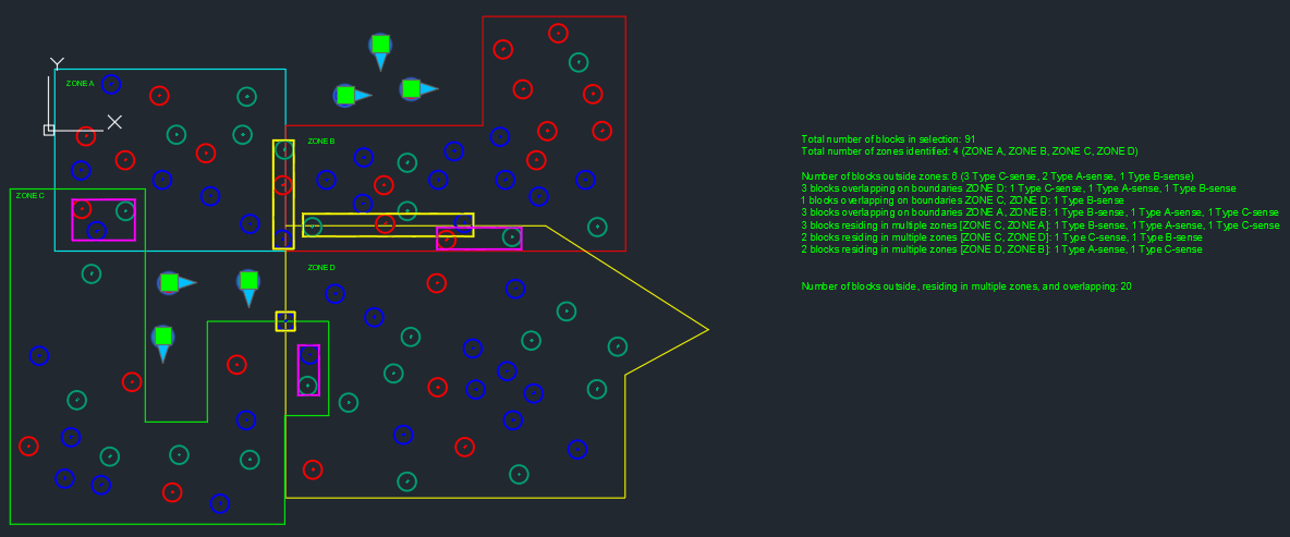

17 minutes ago, Jonathan Handojo said:
If the blocks are not too thin on the polyline (like half the width of the polyline), it should be fine. Because as long as it's hitting the center of the polyline (which is most likely always gonna be true because if your thickness is negligible compared to the size of the block, it doesn't really matter because the picture above had a thickness of 1000 when your actual size is 100), it will catch the block.
Ok got it @Jonathan Handojo sir.
I have included the locked layer check .
Thanks for all your help.

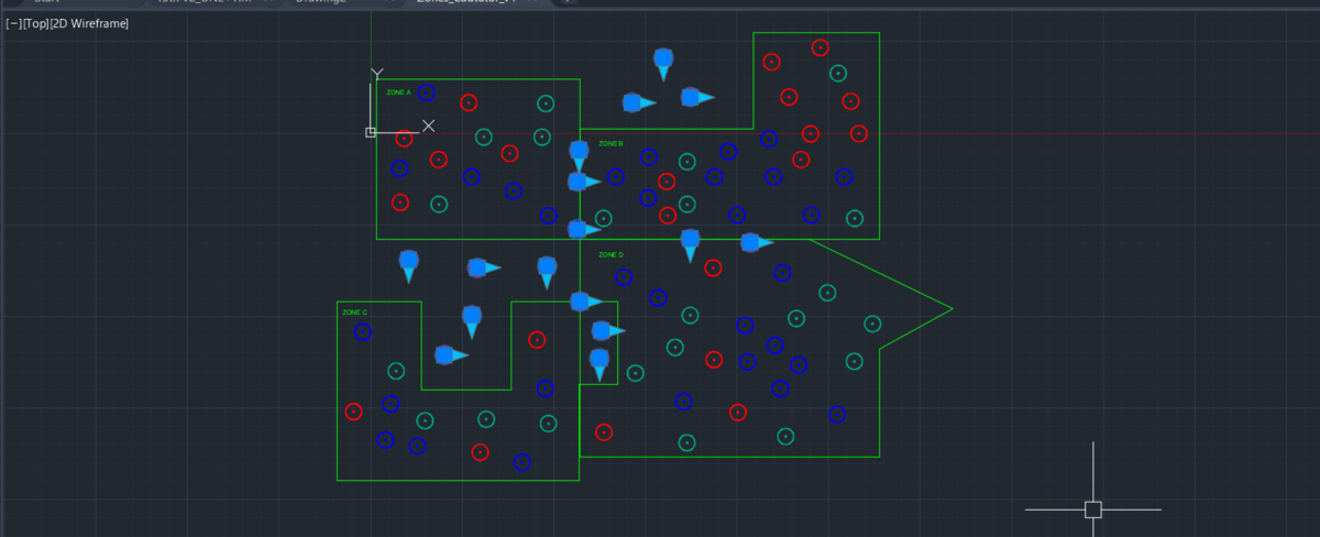

This is only on older versions of AutoCAD.
Try it :)
(setq p1 (getpoint)p2(getpoint))
;; Pan off screen
(ssget "_F" (list p1 p2))

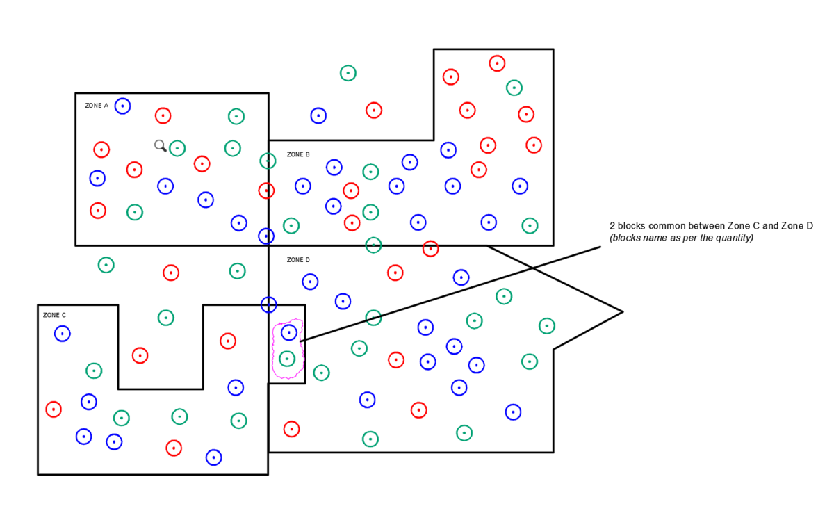

@Jonathan Handojo  sir I have tested your lisp code on numbers of drawing and later realized that I have missed one important case in my sample drawing. I apologize for that .
The check is that each block should be assigned to a single zone only . So there are some cases in which there is overlap of polylines and blocks are lying in the region common to two or more polylines  such blocks should also be highlighted probably by bounding box of different color (refer below image for details)
So the modified report should be somewhat as below for the attached sample drawing:  (underlined is the modified part which report should contain)
Total number of blocks in selection: 90
Total number of zones identified: 4 (ZONE A, ZONE B, ZONE C, ZONE D)
Number of blocks outside zones: 8 (4 Type C-sense, 3 Type A-sense, 1 Type B-sense)
1 blocks overlapping on boundaries ZONE C, ZONE D (1 Type B-sense)
2 blocks overlapping on boundaries ZONE B, ZONE D (1 Type C-sense, 1 Type A-sense)
3 blocks overlapping on boundaries ZONE A, ZONE B (1 Type B-sense, 1 Type A-sense, 1 Type C-sense)
2 blocks lying in region common to Zone C, Zone D (1 Type B-sense, 1 Type C-sense)
Number of blocks outside,overlapping and common to zones : 16
NOTE: If there is no blocks lying into common region between the polylines (zones),then the respective part should be omitted in the report.
Here is the attached sample dwg.

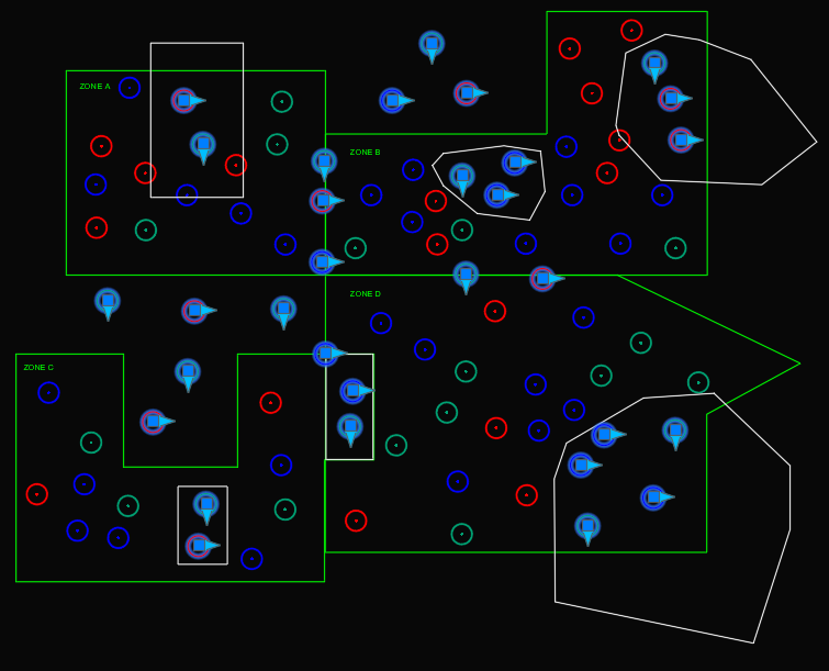

@ronjonp sir can you please update the code to take into consideration the blocks which are also lying in the common region between polylines (zones).I forgot to include it in my previous sample dwg. Here is what the desired result required (refer image) and also find the updated sample dwg attached
Thanks

I've also moved:
  1. The overlapping boundaries to the "NOTINSIDE-Overlaps" layer;
  2. The common boundaries to the "NOTINSIDE-Common Zones" layer, and;
  3. The reporting texts to the "NOTINSIDE-Reports" layer;
so you can just turn off or freeze the layer whenever you feel like it.
I've tested it on a couple complex situations, out of which one of it is below:
Thanks for giving me something to do in the quarantine 🤣
Edited by Jonathan Handojo
