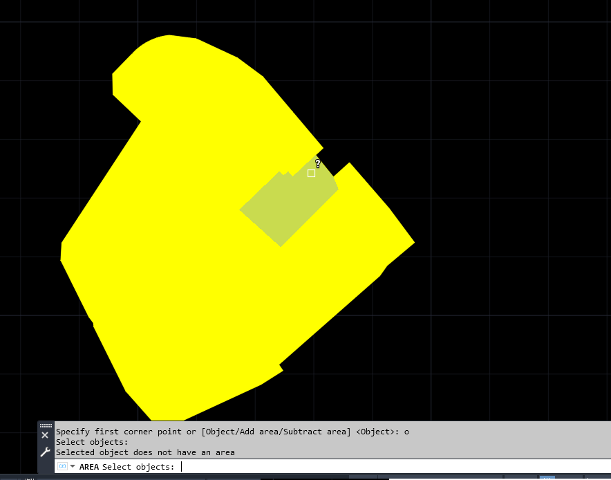

Hi all,
I wrote some code to get total area of selected hatches in autocad, it works well for low selection set, but when I select more hatches, it gives this error :
; error: AutoCAD.Application: Not applicable
What am I doing wrong?

I have found the problem, some hatches don't have area and for this reason the program stop and gives the Not applicable error.

I tried to skip the error with "vl-catch-all-error-p', but I couldn't.
Post a dxf file or AutoCAD 2010 or earlier sample drawing containing hatches and hatches without areas
The unavailability of the ActiveX Area property for a Hatch object is typically a result of the hatch having a self-intersecting boundary. Whilst you could easily circumvent the error that you are receiving using a vl-catch-all-apply expression, this will simply skip over those hatches for which the area property is unavailable and so the total area returned will be inaccurate.

Try this rework. Tested on your provided drawing.
(defun c:hat (/ ss cnt obj ar tot)
  (setq tot 0 ss (ssget '((0 . "HATCH"))))
  (cond (ss
          (repeat (setq cnt (sslength ss))
            (setq obj (vlax-ename->vla-object (setq ent (ssname ss (setq cnt (1- cnt))))))
            (if (vl-catch-all-error-p (setq ar (vl-catch-all-apply 'vlax-get (list obj 'area))))
              (progn (vl-cmdf "hatchgenerateboundary" ent "") (setq ar (getpropertyvalue (entlast) "area"))(entdel (entlast)))
            (setq tot (+ tot ar))
          (alert (strcat "Total Area : "(rtos tot 2 3)))
 The hatch in question had three duplicate points at the start of the reinstated boundary polyline.

Thanks a lot dlanorh, that was very helpful and interesting.
