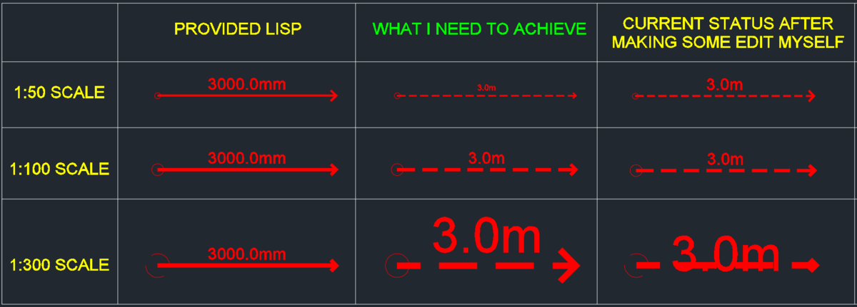

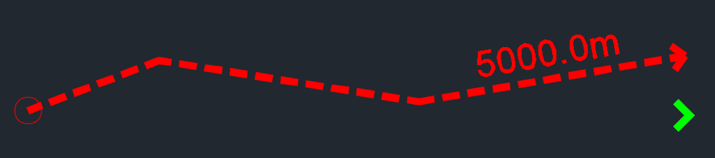

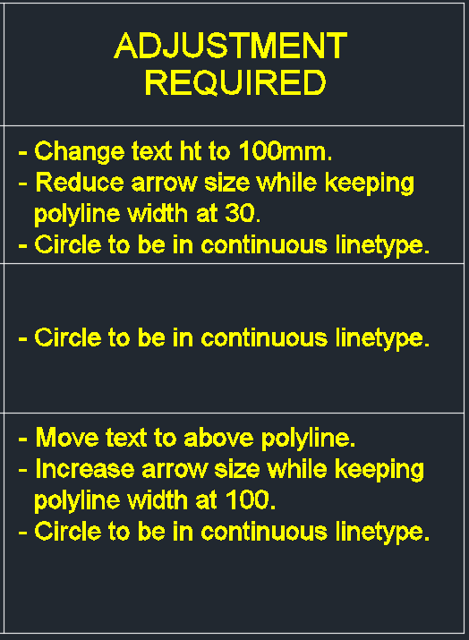

@Jonathan Handojo, omg you made my dream comes true!! 😱 Can I trouble you to make some refinement to the lisp as follow 🙏:
1. Currently the final distance displayed is in mm although the unit shown is in metre (eg. should be 5m instead of 5000m). Can help to make it displays in metre (eg. 5m)? My drawing unit is in mm, fyi.
2. Can make the default text style as Arial?
3. Possible to allow polar / orthomode to be able to turned on during the command?
4. Can make the arrowhead close-end (see green arrowhead below) instead of open-end? This is very minor if can't be done it's fine.
5. I'll need to use this on different scale plans (eg. 1:100 and 1:300). What we have now in the lisp is actually suitable for 1:100 scale plan display, when used on 1:300 scale plan the line type will look too dense, text/arrowhead/circle will be too small. Is it possible at the start of the command it'll ask user to select the scale (100 or 300)? This should only be prompted once when the command is first used on the drawing. Meaning it will not keep prompting this in subsequent use of the command in the same drawing.
Settings for 1:300 scale:
6. Linetype: DASHED2 (acadiso.lin)
7. Polyline width: 100mm
8. Linetype Scale: 1
9. Layer: Use current
10. A circle (continuous linetype) of 400mm diameter to mark the start point of polyline; an arrowhead (continuous linetype) 3x the size of that in 1:100, to mark end of polyline (Refer to screenshot below and attachment).
11. Text Style: Arial
Many thanks in advance! 🙏

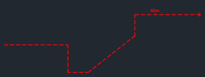

Attached working version if you're interested. Arial textstyle must be defined. Will work in imperial or metric.
dynlenlwp2.lsp
No, you may not....  Just kidding 😁
I've managed to fix all issues you got except for a few...
1. The green arrowhead. I'm not sure how to actually solve that one.
2. I've not included an ortho option since I believe the polar tracking will be enough.
;;;  Tracepoly Instructions                                                                      ;;;
Make sure the arrowhead polyline is explicitly linetype continuous

Hi @Jonathan Handojo, thank you so much for your time and help on this. The arrowhead now is close-ended, probably because you have changed it to continuous linetype. Yes polar tracking is enough :). I managed to edit the lts, text height and line width to suit my needs. However there are a few things that I'll need help with:
image.thumb.png.adc5628e9711e91ffa67f859100e6b4d.pngimage.png.d8fadb360ff70b941957ffd8e5f00b0c.png
For 50 scale - I've tried changed the text ht to 100 but it still display as 200, not sure why; - Need to reduce the arrowhead size keeping line width.
For 300 scale - after increasing the text ht it now overlaps with polyline, need to move text up; - Need to increase the arrowhead size while keeping the line width.
For all scales - Currently the circle is using 'current linetype', need to change to continuous linetype.
I noticed when I toggle to 300 scale and toggle back to 100 or 50 scale the polyline lts will stuck at that used for 300 scale, not sure why. I've attached the above cad file and my edited lisp for your reference.
Lastly, for large scale project on one floor plan I'll need to run this polyline many times with the same scale and distance. Which means need to re-key in the same distance and toggle to the same scale each and every time I run the command. To avoid this is there a way for the command to remember my last used scale and distance and start with them as default in the subsequent use of the command?
Any help on the above is very much appreciated. 🙏  Thank you!

There's a bug when setting the scale to 1.0 which I've never noticed. That's now amended for in this version.
As you requested, this version will remember all your inputs after the very first time completing this command. I've also added a new column "Arrowhead Length" for precautions.
Btw, pressing T will switch the units between "mm", "cm", and "m".
For some reason, idk why the polar tracking is acting weird in your dwg, but it was fine for mine at least when starting a new blank drawing.

Hi @Jonathan Handojo, no words can express how grateful I am to you! 🙏 You have created this awesome lisp that has met all my needs and even beyond. I am sure this lisp can benefit countless people! Once again a big THANK YOU! 👍👍 😂

Hi lisp experts, I have a wild idea for the above lisp, not sure if it is possible.
The above lisp helps one to draw polyline with specified max. length and displays numeric text representing the length of the polyline. Is it possible for the length text to be permanently linked to the polyline (unless someone explode it) such that when one adjusts the polyline vertex which will change the length (but still has a cap to the original specified max. length) the length text displayed will be updated accordingly? 😁
Thank you!!

Hi BIGAL, thank you for responding! Do forgive me for not able to grasp your instruction as I'm not versed in lisp coding 😨 To incorporate the above into the lisp is really beyond my capabilities, unless it's a really very easy type that a layman can do.
Would be very thankful if anyone can help me incorporate this function into the lisp.
