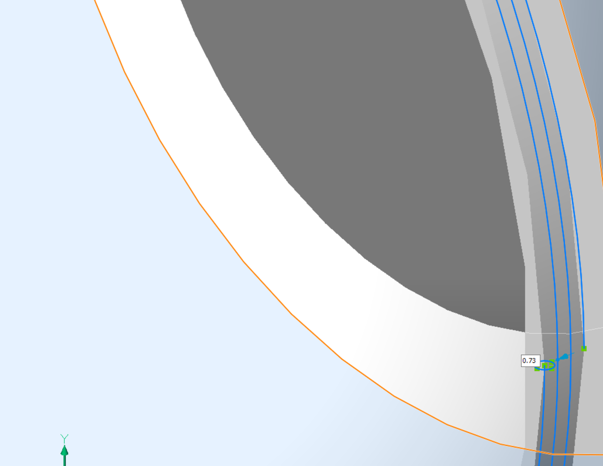

I kepp getting the error :  1 entity was not swept,
what i did is is , sellecting that circle at the end of the helix form and that clicked on sweep command, that selected the helix form as a path, than I get that  couldnt not turn to something error .
Was that the full extent of the error message?  Perhaps the diameter of the circle is greater than the spacing of the coils of the helix?
