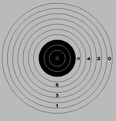

First of all, I would make the Black Bull a donut with internal radius of 0 and external radius 30.885. Then I would make the colour of the Inner Rings 253, and use the Draw Order in Tools to bring that layer to the front. You would only need the three inner rings with default line thickness. I see you have the number 6 twice, once coloured bylayer and the other coloured 255 and your circles have thickness of 2. You have been trying!!!!!!
To look like this:-

@eldon I like the idea of using the 'donut' command. @oly2b It is indeed the hatch colours that are causing the problem so you would be best sticking to just using standard AutoCAD 'white'. I see you tried using the thickness property to give the circles a printed thickness (in AutoCAD thickness actually gives objects a height in the Z direction - off the paper) so using lineweight as you have done for the inner circles is actually the correct way to go, except you are limited to a width of 2.11mm. For anything 'wider' than that then you need to look at using polyline width. You cannot turn a circle into a polyline, but you can turn an arc into a polyline (so 2 half circle arcs can be a polyline) and this is what the Donut command creates so 4 inner donuts using inner and outer diameters of :
0 - 2.5
3 - 13
13.5 - 22
22.5 - 31
and then your outer circles with a linewidth of 0.5 should print as you are hoping giving you outer black circles 0.5mm wide and inner white circles also 0.5mm wide (though you might need to adjust the donut sizes I have used if this needs to be accurate for competition targets.
