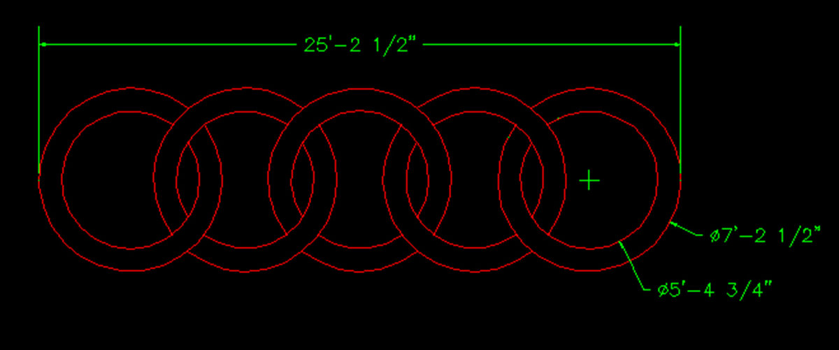

Many students find this one to be especially vexing. It is a good intro to commands that use existing objects to position others. Also, trimming is fun!
Draw the rings!

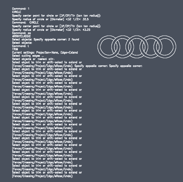

The image is supplied to help elucidate for those who are new to AutoCAD.
Definitely could have saved TRIM clicks by just doing half of it and mirroring!  :ouch:
Edited by Dadgad

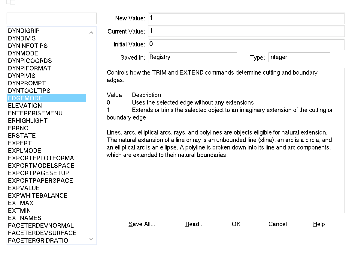

I wonder if you look in SYSVDLG at the explanation of EDGEMODE, if it is different than the one shown from 2016?

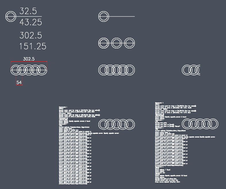

Dadgad
I was raised and spent 45 years in the States, did a lot of carpentry,
but typically work in mms, been thinking metric for 25 years now, couldn't be bothered using feet.
Set my -dwgunits to inches and entered decimally, so as to avoid using fractions.
Knowing the overall length I created the first loop, on the left
I then drew a line from the West quadrant of that circle of the overall length, and
Then mirrored that ring across the midpoint of the overall length line.
Copied a ring from Center to Midpoint of the length line.
Copied it again from Center to Mid Between 2 points snaps on the 1st and 3rd rings
Mirrored that second ring across the line midpoint to create the 4th ring.
I think the TRIM is pretty self evident, using the SELECT ALL pick style.
In short, create the line of overall length
place two rings at the endpoints and one at the midpoint
copy a ring to the midpoint between the 1st & 3rd, and the 3rd & 5th.
Having already drawn it this way I knew my Array spacing should be 54
when doing it again as per the commandline histories shown in the screenshot.
I should have just used LeeMacs Divide lisp, I looked for on his site, wanted to link to it, as it is great, but couldn't find it.
This screenshot shows both ways I did it.
Edited by Dadgad

Edgemode looks unchanged (help files, there is no sysvdlg in LT) so the default may have changed to trimall but the firts prompt was indeed 'Select objects or <select all>: ' and now it reads '[cuTting edges/Crossing/mOde/Project/eRase]: '. But what is new is the projection modes UCS, view and 3D. Plus you can now use line elements in a hatch to act as trim objects (new variable 'trimedges' 0=trim to hatch boundary 1=trim to hatch pattern whilst in quick mode).
