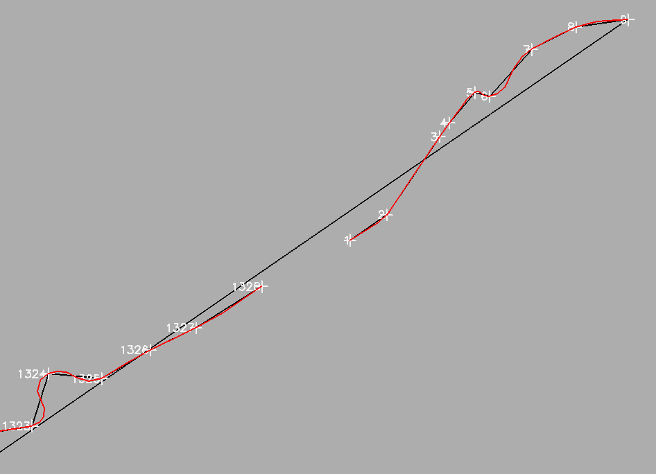

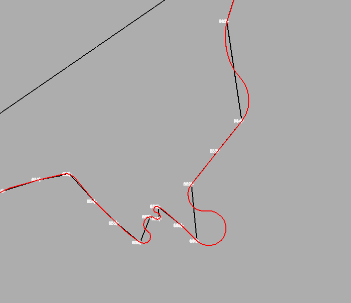

eldon Posted May 25, 2020 Share Posted May 25, 2020 Your data was a bit muddled. The first nine points seem to come after the 1328th point! So I plotted all the points and drew a polyline (black line) between them. The long straight line is the joining up of point 9 with point 10. Then I copied the polyline and used the option Fit in the polyline edit command to give the red line. AutoCAD curve fits as best it can between the points and the resultant line goes through all the points. Whether this meets with your requirements, you have to decide. If you can calculate in Excel a revised set of points, it can be quickly drawn in AutoCAD. Quote Link to comment Share on other sites More sharing options...
