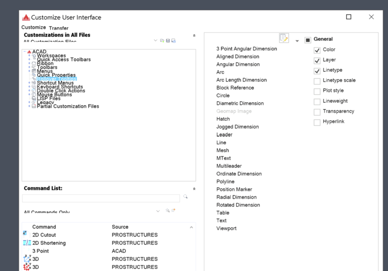

4 hours ago, steven-g said:
BINGO!  Rollovertips has got you covered.   :beer:
If you go into your CUI and care to, you can define which of the available General Properties you care to display in the Rollover Tip, check those you want.
If you are too lazy to remember the name of the system variable it is also available in OPTIONS, on the DISPLAY tab.
Additionally, the LEE-MAC lisp to which dlanorh supplied the link will, of course since Lee Mac wrote it, do even more!   :beer:
Thanks Lee!  When in doubt, check Lee Mac out!

In this case, hanhphuc provided the best solution that I'm after. I'm basically working with thousands of entangled lines and I just need to know where they sit, so that I can use other LISP routines to change them to the layers that I need to. Using a rollover seems to take time and the slightest move of the mouse will make it disappear. It doesn't somehow seem user-friendly if you're a fast worker.
Not to say the least, the code provided by dlanorh also works, but is somehow very slow in my computer.
ssget is a brilliant idea, didn't cross my mind there. Thanks hanhphuc. With this as a start, I can then organise which layers are prior to display first compared to others (for example, if two objects are overlapping the cursor).
