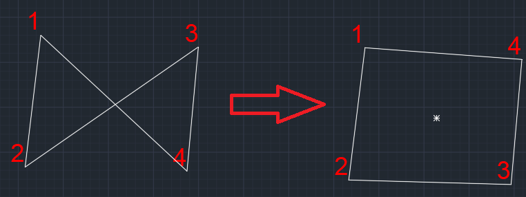

Hi all, I have four coordinates for each polygon in excel, number of some polygons isn't sort and when I draw them in google earth or autocad by vba programming, interference occurs, can we resort them to NonIntersecting  coordinates?.: (number of points is not important)

Maybe centre point then angle to each point sort points based on angle, ok for a polygon with no reverse points like a L.

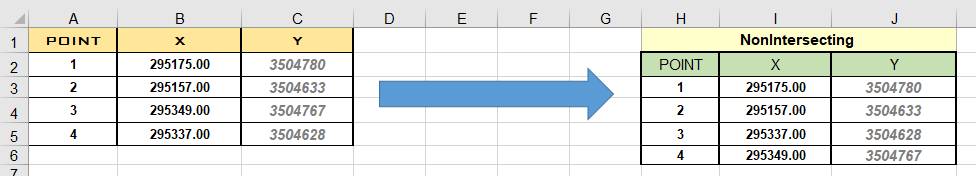

Hi bigal, I don't know how I can find angle in excel, but I attached sample excel file
Sample.xlsm

Macro added. Click  B<>C or C<>D
Sample-macro.xlsm

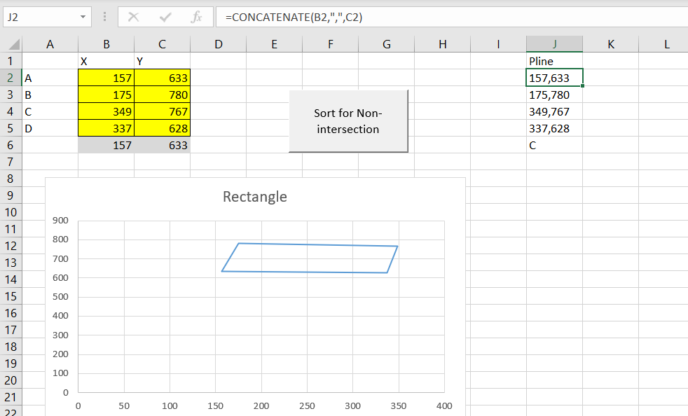

The attached macro-enable Excel file will sort 4 points such that the results will not have intersecting edges.
It computes the area of three different configurations and uses the configuration with the greatest area as the sorted solution.
BEFORE Execution
AFTER Execution
INTERSECTING LINES.xlsm
That was great lrm, thank you so much.

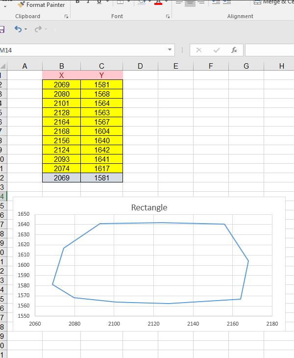

The macro resolved my problem, but will the macro work if the points will be more than 4 points in the future? (for example 10 points). like this :

Any way so long as you always have a convex shape this should work. It looks at an internal angle of the points so no graph's etc required, H pattern will not work.
Use in excel cell F2 =(concatenate("point ",B2,",",C2) then copy down and copy and paste like sample F2-F11, As "close" is part of code so no need for last point.

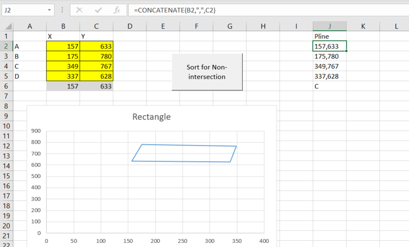

@amir0914 No, my program is only intended to work for 4 points.

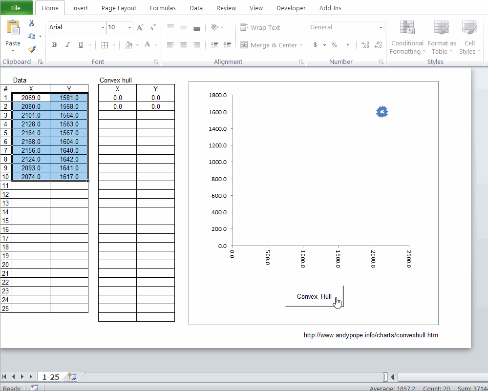

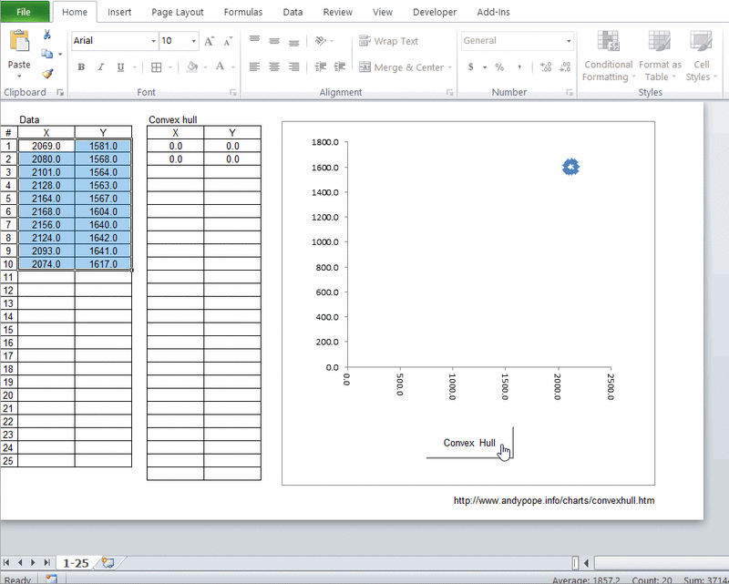

LISP try LM:ConvexHull
or
ExcelForum -  VB site hosted by www.andypope.info has been reported as unsafe!
Edited by hanhphuc
or
Hi hanhphuc, it is awesome, can you attach the exact file that your testing on the attached image? I downloaded from  "www.andypope.info", but it's not  the same file and also changes the original coordinates.
Edited by amir0914
The author already commented nicely, so just omit sub m_AddPaddingPoints
