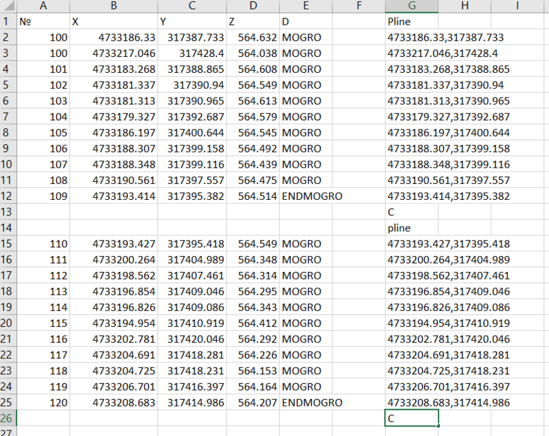

rudy I was thinking more and a excel answer may be appropriate, you can do things like
Pline
x,y
x,y
x,y
pline
x,y
x,y
In a column just copy the column rows and paste to the command line, pline will be drawn. So code independent can add layer etc.
Do you know about VBA in excel ?
Post a real file to have a look at. Excel supports a space as delimeter.
Copy column G1-G26 to the command line two plines will appear. testmogro.xlsx

I like the idea for different code and now i will ask for something more complicated if it possible to group them like
((1 2 3 7) (1 4 5) (2 5 6) (3 6)) when we use D for key.
My idea is to collect all point with "1" at descriptoion after that with "2" and ...
I realy appriciate the help from all
hello BIGAL i think for this but when i use shape lines some times i need to revers the line.
But i like your idea for code its much better than mine with your method i can have 1 start poit for 2-3-X  lines.
Link to post
Post a real file please.
As I said earlier a double sort in excel on number and "D" will make it look like your sample, 7 would be at start.
Save as csv much easier for a line that is a point only the "D" becomes a null string. Then yes could multi loop through code looking for patterns using "." so could have more than 2, 1.3.4MOGRO.
Just me would make ((layer xy xy xy xy)(layer xy xy)(layer xy xy xy xy xy xy)) etc saves going back through the master list multiple times to get the xy. Did you want 3dpoly ? Can be xyz.
Edited by BIGAL
Link to post

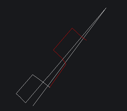

Hello BIGAL i dont have real measurments with codes, we use other codes  and we draw  piece by piece.
But these coordinates are pretty real i draw a lines and create the .txt file.
And for that reason i create this lisp and very appriciate your advice.
I create something where sort and create just what i need.
If someone want i can uppload it .
Hello pBe i change everything from the main idea but work for now , i create 1 from maybe 15+ different (fence, Buildings, road, ...) but work, from now on i will just add new things.
But I would not have succeeded without your help.
Thank you again everyone.
