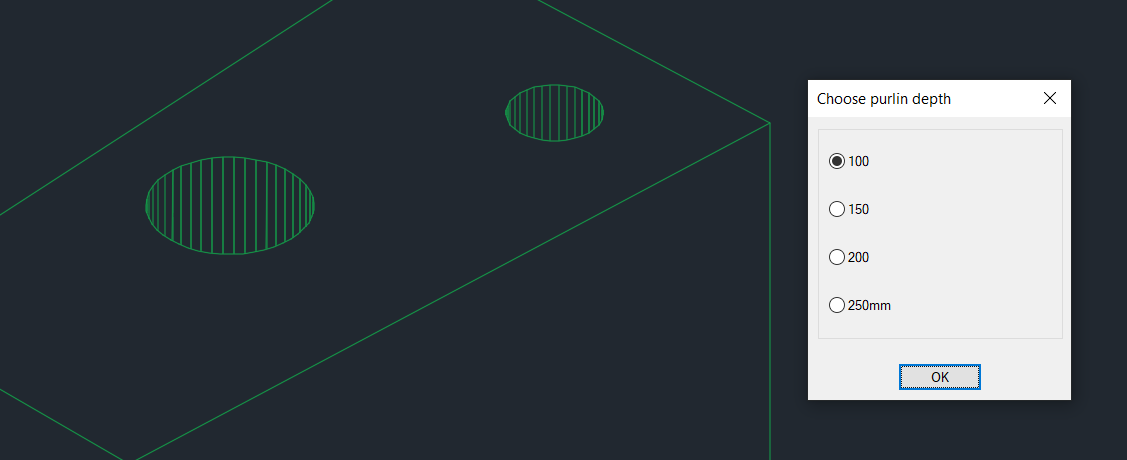

BIGAL Posted June 25, 2020 Share Posted June 25, 2020 (edited) Redo this (defun rect () If you make rectang and extrude (setq ent1 (entlast)) make circle extrude (setq ent2 (entlast)) make circle extrude (setq ent3 (entlast)) Subtract ent1 objects ent2 ent3 "" Dcl is Multi Radio Buttons.lsp (setq ans (ah:butts but "V" '("Choose purlin depth" "100" "150" "200" "250mm "))) Multi radio buttons.lsp Edited June 25, 2020 by BIGAL Quote Link to comment Share on other sites More sharing options...

hanhphuc Posted June 27, 2020 Share Posted June 27, 2020 (edited) FWIW (defun opt? (% msg / $) (ai_sysvar '(("DYNMODE" . 3))) (initget 1 (vl-string-translate "/" " " %)) (setq $ (getkword (strcat "\n" msg " [" % "] : "))) (ai_sysvar nil) $ ) eg: %=keyword slash "/" delimited (setq a (atoi (opt? "100/150/200/250" "Enter purlin depth mm"))) select mouse double-click as BCAD or down-arrow key to show radio button (ACAD only?) Edited June 27, 2020 by hanhphuc link Quote Link to comment Share on other sites More sharing options...
BIGAL Posted June 27, 2020 Share Posted June 27, 2020 Very good simple method any way to centralise the choice ? it may be a registry entry. Quote Link to comment Share on other sites More sharing options...
