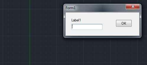

handasa Posted July 13, 2020 Share Posted July 13, 2020 Hello Everone does anyone know a method to make user able to use autocad while a dcl dialogue is open in background? i.e user can switch to a currently opened dcl and for example if he clicked the button named "ok" this trigger certain command in autocad without closing the dcl dialouge file and make autocad usable in the same time. thanks in advance Quote Link to comment Share on other sites More sharing options...
BIGAL Posted July 13, 2020 Share Posted July 13, 2020 Short and quick can not be done, must close DCL do your thing and reopen. Quote Link to comment Share on other sites More sharing options...
handasa Posted July 13, 2020 Author Share Posted July 13, 2020 5 minutes ago, BIGAL said: Short and quick can not be done, must close DCL do your thing and reopen. is there any dcl alternative to do this? Quote Link to comment Share on other sites More sharing options...
BIGAL Posted July 13, 2020 Share Posted July 13, 2020 Would it just not be easier to just ask pick or enter new value. Quote Link to comment Share on other sites More sharing options...
dlanorh Posted July 13, 2020 Share Posted July 13, 2020 4 hours ago, handasa said: is there any dcl alternative to do this? Have a look at OpenDCL, I think they have a non modal form. Quote Link to comment Share on other sites More sharing options...
handasa Posted July 14, 2020 Author Share Posted July 14, 2020 On 7/13/2020 at 11:07 AM, dlanorh said: Have a look at OpenDCL, I think they have a non modal form. ok.i will give it a try,thank you Quote Link to comment Share on other sites More sharing options...
handasa Posted July 14, 2020 Author Share Posted July 14, 2020 On 7/13/2020 at 6:25 AM, BIGAL said: Would it just not be easier to just ask pick or enter new value. i need dcl visible while user is using autocad for some purpose thank you Bigal Quote Link to comment Share on other sites More sharing options...
jonathann3891 Posted July 15, 2020 Share Posted July 15, 2020 You can also accomplish this with VBA, if its installed. Quote Link to comment Share on other sites More sharing options...
