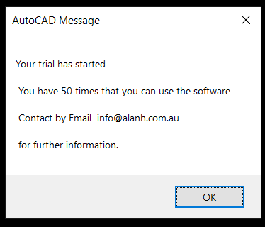

hi friends ... can we license autolisp? or can we put a password ? how can ı do it?
Edited by klavye1
Various ways of adding passwords
1 look at Disk ID
2 look at registry
3 ping a web server
4 check a web site for date no wind clock back
5 look for a file
Most important compile your lisp to a  fas file.
Just lisp you need to decide which method, just google.
Here is a couple of samples. If I had a web server would possibly do a ping test. The code is at the start of the lisps and uses (EXIT) which does just that exits the lisp.
speech time lapsed.fas Test fas.fas
