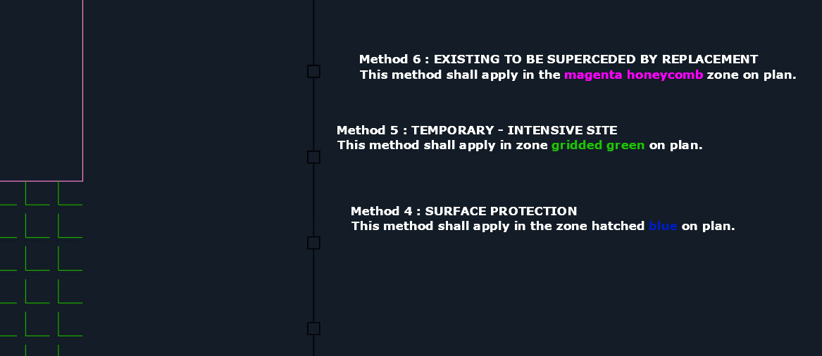

GGuzzler Posted July 21, 2020 Share Posted July 21, 2020 (edited) Hi all, Normally, I print plans from AutoCAD in greyscale, using TrueColor for the objects I want to display in colour. I find that when I paste in text from an MS Word report, parts of the text display as TrueColor RGB values, and others default to AutoCAD Index Colors. Is there a way for any text pasted in to default to TrueColor rather than a mix of both? I'm currently going through the text and laboriously changing each instance to RGB colour, but I imagine there must be a better way which you friendly internet strangers know already! Many thanks in advance! Edited July 21, 2020 by GGuzzler Quote Link to comment Share on other sites More sharing options...

GGuzzler Posted July 23, 2020 Author Share Posted July 23, 2020 On 7/21/2020 at 6:43 PM, Cad64 said: This works for me: 1. In Word, select and copy the text you want. 2. In Autocad, Start the Mtext command and then paste the text into the Mtext Window. Thanks for taking the time to reply - the problem there for me is that the magenta honeycomb and the pink revert to 'Magenta' and 'Color 231' even when I've pasted them in as MText, and so they don't print out as their actual colour when I print in greyscale. Quote Link to comment Share on other sites More sharing options...

GGuzzler Posted July 23, 2020 Author Share Posted July 23, 2020 22 hours ago, SLW210 said: Save your Word file as RTF and use the Import Text feature. Unfortunately the magenta and pink stay stubbornly as 'Magenta' and 'Color 231' rather than their RGB values Quote Link to comment Share on other sites More sharing options...
SLW210 Posted July 23, 2020 Share Posted July 23, 2020 Redo those colors in your Word Document. I selected them and slightly changed the current colors and they came in RGB. Quote Link to comment Share on other sites More sharing options...
GGuzzler Posted July 23, 2020 Author Share Posted July 23, 2020 1 minute ago, SLW210 said: Redo those colors in your Word Document. I selected them and slightly changed the current colors and they came in RGB. Ah ok ... unfortunately that means a company-wide adjustment to our templates - but it may be the best way forward. Thank you for being generous with your time! Quote Link to comment Share on other sites More sharing options...
