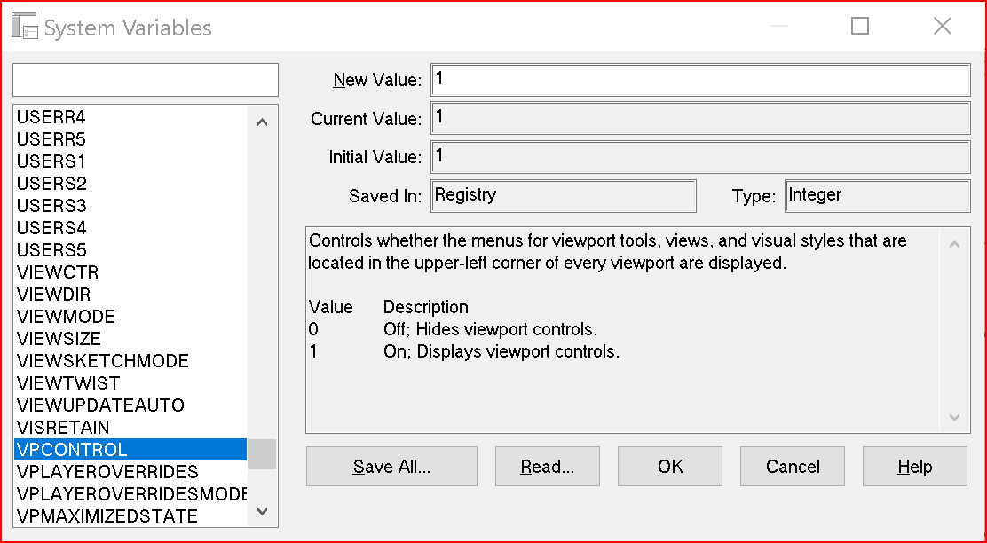

If you are working in a Viewport and you have your Viewport Controls turned on (by default they are turned on)
Working within a Viewport you can also change your View and Visual Styles using them.
