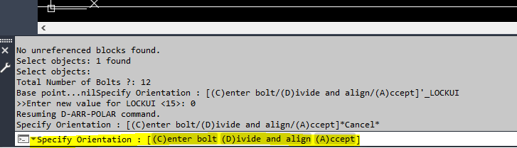

Sambuddy Posted September 16, 2020 Author Share Posted September 16, 2020 (edited) Could someone help me with this please? I am trying to create a getstring instead of pressing "V" then "enter an angle" to make the angle go 0.00 (center bolt) or 15.00 (divide) for example. so each time I click in each string would toggle between 0 and 15 degrees and display as such. Anyone please? ;| ;; DYNARRAY FUNCTION ;; By: andrea Andreetti 2009-01-03 ;; ;; Update 1.1 By A.A. 2009-01-03 ;; OrthoMode Added ;; ;; Update 1.2 By A.A. 2009-01-04 ;; Allow User to enter an Angle Value ;; ;; Update 1.3 By A.A. 2009-01-04 ;; Allow Polar array ;; not abort anymore when anykey is pressed ;; |; (defun c:DAR (/ sent Dbasepoint DtoPoint #Copy SSlist P0 ang dist entcopy input Operation orthm Dmess1 Dmess2 Dmess3) (if (vl-string-search "FR" (strcase (ver))) (setq Dmess1 "\nNombre de CopyArray: " Dmess2 "Point de base..." Dmess3 "\nAppuyez sur V pour entrer la (V)aleur de l'angle :" Dmess4 "\n(R)ectangulaire ou (P)olaire ?: " ) (setq Dmess1 "\nNumber of CopyArray: " Dmess2 "Base point..." Dmess3 "\nPress V to enter any Angle Value :" Dmess4 "\n(R)ectangular or (P)olar ?: " ) ) (vl-load-com) (setvar "CMDECHO" 0) (defun *error* (msg) (if SSlist (progn (foreach n SSlist (vl-cmdf "._explode" n) ) (setq SSlist nil) ) ) (vl-cmdf "._explode" item) (vl-cmdf "._-purge" "_B" "_{DarrayBlock}_" "_N") (redraw) (princ (strcat "\n" msg)) ) ; (initget "R P") (setq RorP (getKword Dmess4)) ; (vl-cmdf "._-purge" "_B" "_{DarrayBlock}_" "_N") (setq sent (ssget)) (setq #Copy (getint Dmess1)) (setq Dbasepoint (getpoint Dmess2)) (vla-StartUndoMark (vla-get-ActiveDocument (vlax-get-ACAD-Object)) ) (vl-cmdf "._-block" "_{DarrayBlock}_" Dbasepoint sent "") (vl-cmdf "._-insert" "_{DarrayBlock}_" Dbasepoint "" "" "") (setq item (entlast)) (setq Bdatax (entget item)) (setq snapA (getvar "snapang")) (setq orthm (getvar "ORTHOMODE")) (princ Dmess3) (DarrayWhile);_while (while (and (not (= (car input) 25));RIGHT CLICK (not (= (car input) 3));LEFT CLICK (not (and (= (car input) 2) (= (cadr input) 32)));ESCAPE (not (and (= (car input) 2) (= (cadr input) 13)));ENTER ) (DarrayWhile) ) (redraw) (if SSlist (progn (foreach n SSlist (vl-cmdf "._explode" n) ) (setq SSlist nil) ) ) (vl-cmdf "._explode" item) (vl-cmdf "._-purge" "_B" "_{DarrayBlock}_" "_N") (vla-EndUndoMark (vla-get-ActiveDocument (vlax-get-ACAD-Object)) ) (princ) ) ;; ;| ;; DYNARRAY FUNCTION ;; |; ;| ;; WHILE FUNCTION ;; |; ;; (defun DarrayWhile () (while (or (and (setq input (grread t 4 4))(= (car input) 5)) (and (= (car input) 2) (= (cadr input) 15)) ; F8 Orthomode (and (= (car input) 2) (= (cadr input) 118)) ;v (and (= (car input) 2) (= (cadr input) 86)) ;V ) (setq PC Dbasepoint) (setq P0 Dbasepoint) (if (= (car input) 5) (setq DtoPoint (cadr input))) (if (and (= (car input) 2)(= (cadr input) 15)) (setq Operation "ORTHO") ) (if (or (and (= (car input) 2) (= (cadr input) 118)) ;v (and (= (car input) 2) (= (cadr input) 86)) ;V ) (setq Operation "VALUE") ) (if (eq Operation "VALUE") (progn (setq snapA (dtr (getint "\nSpecific Angle :"))) (setq orthm 1) (setq Operation nil) (princ Dmess3) ) ) ;;SWITCH ORTHOMODE ;; ;; (if (eq Operation "ORTHO") (progn (if (eq orthm 1) (progn (setvar "ORTHOMODE" 0) (setq orthm 0)) (progn (setvar "ORTHOMODE" 1) (setq orthm 1)) ) (setq Operation nil) ) ) (if (eq orthM 1) (DarrayOrthoMode1) ) ;; ;;SWITCH ORTHOMODE ;; (if (eq RorP "R") ;;RECTANGULAR (progn (setq ang (angle DbasePoint DtoPoint)) (setq dist (/ (distance Dbasepoint DtoPoint) (1- #Copy))) (redraw) (if SSlist (progn (foreach n SSlist (vl-cmdf "._erase" n "") (princ) ) (setq SSlist nil) ) ) (repeat (1- #Copy) (setq P0 (polar P0 ang dist)) (DynArray_go P0) (princ) ) ) ;;POLAR (progn (setq ang (angle DbasePoint DtoPoint)) (setq dist (distance Dbasepoint DtoPoint)) (redraw) (if SSlist (progn (foreach n SSlist (vl-cmdf "._erase" n "") (princ) ) (setq SSlist nil) ) ) (setq angP (/ 360 #Copy)) (repeat #Copy (setq ang (dtr (+ (rtd ang) angP))) (setq PC (polar Dbasepoint ang dist)) (DynArray_go PC) (princ) ) ) ) ) ) ;; ;| ;; WHILE FUNCTION ;; |; ;;;;| ;; ;;; DYNARRAY COPY ;; ;;; |; ;;; ;; ;;;(defun DynArray_go ( NP / entcopy Bent) ;;;(redraw) ;;;(grdraw Dbasepoint DtoPoint 4 1) ;;;(setq Bdatax (subst (cons 10 P0) (assoc 10 Bdatax) Bdatax)) ;;;(setq Bent (entmakex Bdatax)) ;;;(setq SSlist (append SSlist (list Bent))) ;;;) ;;; ;; ;;;;| ;; ;;; DYNARRAY COPY ;; ;;; |; ;| ;; DYNARRAY COPY ;; |; ;; (defun DynArray_go ( NP / entcopy ) (redraw) (grdraw Dbasepoint DtoPoint 4 1) (vl-cmdf "._copy" item "" "_non" Dbasepoint "_non" NP) (setq entcopy (entlast)) (setq SSlist (append SSlist (list entcopy))) ) ;; ;| ;; DYNARRAY COPY ;; |; ;| ;; DYNARRAY ORTHOMODE ;; |; ;; (defun DarrayOrthoMode1 (/ distP NorthP WestP EastP SouthP) (setq distP (distance Dbasepoint DtoPoint)) (setq NorthP (polar Dbasepoint (+ snapA (dtr 90)) distP)) (setq WestP (polar Dbasepoint (+ snapA (dtr 180)) distP)) (setq EastP (polar Dbasepoint snapA distP)) (setq SouthP (polar Dbasepoint (- snapA (dtr 90)) distP)) (if (and (< (distance DtoPoint NorthP) (distance DtoPoint WestP)) (< (distance DtoPoint NorthP) (distance DtoPoint EastP)) (< (distance DtoPoint NorthP) (distance DtoPoint SouthP)) ) (setq DtoPoint NorthP) ) (if (and (< (distance DtoPoint WestP) (distance DtoPoint NorthP)) (< (distance DtoPoint WestP) (distance DtoPoint EastP)) (< (distance DtoPoint WestP) (distance DtoPoint SouthP)) ) (setq DtoPoint WestP) ) (if (and (< (distance DtoPoint EastP) (distance DtoPoint WestP)) (< (distance DtoPoint EastP) (distance DtoPoint NorthP)) (< (distance DtoPoint EastP) (distance DtoPoint SouthP)) ) (setq DtoPoint EastP) ) (if (and (< (distance DtoPoint SouthP) (distance DtoPoint WestP)) (< (distance DtoPoint SouthP) (distance DtoPoint EastP)) (< (distance DtoPoint SouthP) (distance DtoPoint NorthP)) ) (setq DtoPoint SouthP) ) ) ;; ;| ;; DYNARRAY ORTHOMODE ;; |; ;; ;; ;; Degree Conversion ;; ;; ;; ;; (defun dtr (a) (* pi (/ a 180.0)) ) (defun rtd (a) (/ (* a 180) pi) ) (c:dar) ;; ;; ;; ;; Degree Conversion ;; ;; ;; Edited September 16, 2020 by Sambuddy added explaination Quote Link to comment Share on other sites More sharing options...
BIGAL Posted September 16, 2020 Share Posted September 16, 2020 Thats not in your code ? Could use my Multi radio buttons just not sure about your question, if pick divide could do another radio button with angles 90 45 22.5 etc. Quote Link to comment Share on other sites More sharing options...

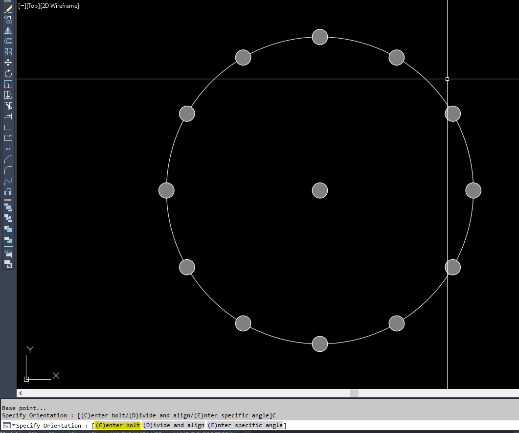

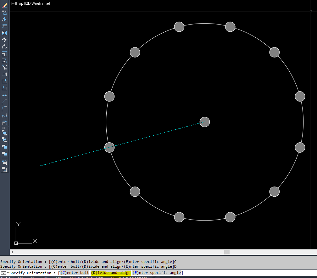

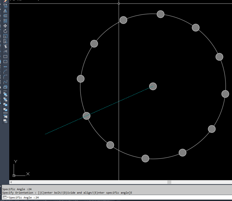

Sambuddy Posted September 17, 2020 Author Share Posted September 17, 2020 11 hours ago, BIGAL said: Thats not in your code ? Could use my Multi radio buttons just not sure about your question, if pick divide could do another radio button with angles 90 45 22.5 etc. As it is often the case, I was not clear on my question! So, this is the variable that calls for specifying an angle: Dmess3 "\nPress V to enter any Angle Value :" and, this is the portion on the routine that I needed help with: (if (eq Operation "VALUE") (progn (setq snapA (dtr (getint "\nSpecific Angle :"))) (setq orthm 1) (setq Operation nil) (princ Dmess3) ) ) so I ended up using this addition to the routine: (setq Dmess3 (getstring "Specify Orientation : [(C)enter bolt/(D)ivide and align/(A)ccept]")) (cond ((= Dmess3 "C") (progn (setq snapA (dtr 0.00)) (setq orthm 1) (setq Dmess3 nil) (princ Dmess3) )) ((= Dmess3 "D") (progn (setq snapA (dtr 15.00)) (setq orthm 1) (setq Dmess3 nil) (princ Dmess3) )) (T(command)) ) but it did not work. I can see the visual orientation in realtime on the model space when I select for example: "(C)enter bolt" but as soon as I click on other selections the angle does not reset to implement my other choice. "0.00" and "15.00" is only a wacky degrees I gave as an example. Depending on the number of bolts and the allowances/ conditions I will put later on this routine this value is calculated so it is not a known degree - I just want the routine to give me 0 and 15 so I am certain that I have a good piece to go by before replacing them with proper variables that justify the angle of rotation. Please pay no attention to the meaning of "(C)enter bolt" or "(D)ivide and align" as it is just a wacky string,, it could have been "Position-A or B" or "blah-1 or 2". My goal is this: circle: 360 degrees. If the input on "total number of bolts" is 12 then 360/12=30 degrees. Then I could Position-A=0 and Position-B=15 (half the determined angles based on 12 bolts). what 0 does is placing the bolt to align with horizontal line, so at 90 degree angle, from the horizontal, I would have one bolt centered on 90 degrees. If I choose say "Position-B", then I would have 90+15=105 degrees from the horizontal line - so my bolt is 15 degrees away from the 90 degree angle. I should be able to go back and forth and it should each time displays each position until I make up my mind and select the position I want and "(A)ccept" my selection. The question then is not using a radio button, as I have hundreds of times on my past routine - thanks to you @BIGAL, it is that it would not suit with what I am trying to accomplish. In short: I do not want to enter values, I want to select so the angle resets then reads my custom angle and show me the result in real-time, as it is the case right now with this routine without my next intervention! Thanks, Sam Quote Link to comment Share on other sites More sharing options...
Sambuddy Posted September 17, 2020 Author Share Posted September 17, 2020 This was what I meant just in case anyone is interested in my method: (setq angvalask (getstring "\nSpecify Orientation : [(C)enter bolt/(D)ivide and align/(E)nter specific angle]")) (cond ((= angvalask "C")(setq Operation "option-1")) ((= angvalask "D")(setq Operation "option-2")) (T (setq Operation "option-3")) (if (or (and (= (car input) 2) (= (cadr input) 118)) ;v (and (= (car input) 2) (= (cadr input) 86)) ;V ) ;;;(setq Operation "VALUE") (setq Operation "option-1") ) (if (eq Operation "option-1") (progn ;;;(setq snapA (dtr (getint "\nSpecific Angle :"))) (setq snapA (dtr 0)) (setq orthm 1) (setq Operation nil) ;(princ Dmess3) ) ) Only that my placement of the condition was inaccurate, so it always ended up with an error - whereas now, everything is working great! so now I can toggle between the options and it shows me on the screen what the best orientation is - This is important to me because of the collar design I have and bolt holes should match the existing supports. Quote Link to comment Share on other sites More sharing options...
