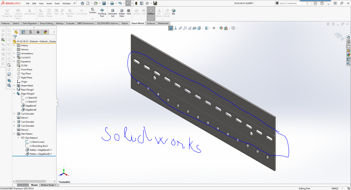

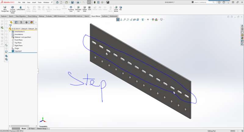

how to convert the solidworks file to a step file or another format file while keeping the curves in sheet metal of solidworks?
image.thumb.png.2075710192e420b39b2a3fa1fd235a13.pngimage.thumb.png.62e4edefdb15ab7e04a71675050cad99.png

The things highlighted look to be bend line sketches?
A step file has no concept of these, it just has the geometry, so I don't think you will be able to achieve what you are after
