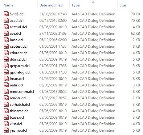

So , I searched in the System partition , ALL the DCL files :
Then , I checked the keywords 'Point' or 'size' . ONLY few DCL files have this keywords , but none of them was related to command 'pType' , as was mentioned above .
I don't have 'ade.dcl' , instead I have 'ase.dcl' .
in conclusion :
1. maybe I didn't find ALL the DCL files ( improbable) ;
2. the command 'pType' is not using a DCL file / statement ;
3. the DCL is generic as : "button1" , "button2" ... "text1" "text2" .. "toggle1" "toggle2" ... and a lisp /software set the label/key of the Button / Text / toggle as 'Point style' , 'Point size' , etc .
Was a greate ideea , but no success .
Regards ,
Edited by Costinbos77

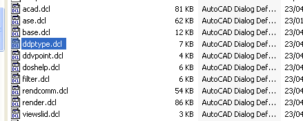

Out of idle curiosity, I had a look in my Autodesk Support folder, and there was ddptype.dcl
Hi eldon ,
I searched again , i dont have your files , please , can you share it ?
I am surprised that it is apparently not still included, so beware in case it is version dependant!!

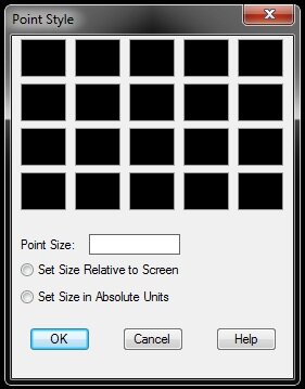

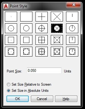

Thanks eldon ,
it is a small difference in the arrangement of texts :
Please , can yoy specify from what version of AutoCAD is ?
Maybe the other fellows can specify if they finded or not in them AutoCAD version . Them help will be appreciated !

Thanks Eldon DDptype lsp & DCL
Constinbos77 "C:\Program Files\Autodesk\AutoCAD 20XX\Support\ddpType.dcl" ;  not there CIV3D 2020. maybe only older versions.
Tombu Acad.slb is in "C:\Program Files\Autodesk\AutoCAD 20XX\Support\EN-US" ; or similar
Constinbos77 you will have to pull all the relevant bits out of DDptype.lsp and add to your lsp. So can open ptype as child dcl.

Hi gents ,
1. Thank you very much Eldon for all the good stuff [ ddpType.dcl , ddpType.lsp ! Working excelent if the dcl it is in the right path  !
The image thing , looks interestig , I need to do some more research about it .
2. Thank you very much BigAl for your help / advices , are welcome and appreciated as always !
