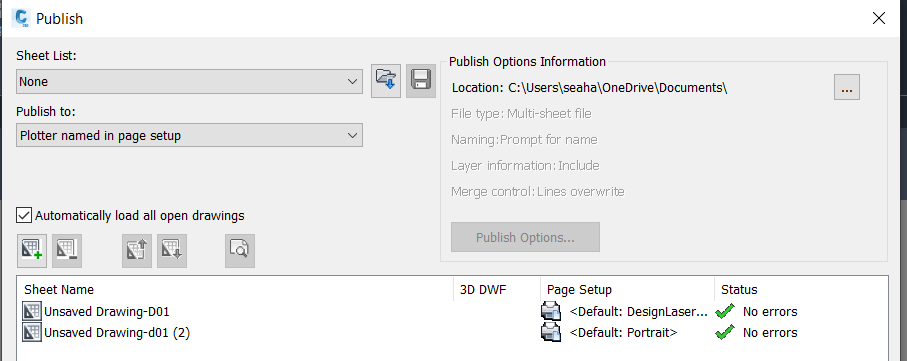

one of the drafters used their base template of landscape layout but added some portrait viewports for my own personal use externally.
this is great with plotting individually, but if I try to publish these pages they all print in landscape, cropping the pages.
I was wondering if there are any guru's out there that may know a solution? it might be a simple fix and I am just a moron, but any help would be appreciated.

Using publish you would have to save the plot setup for each layout.

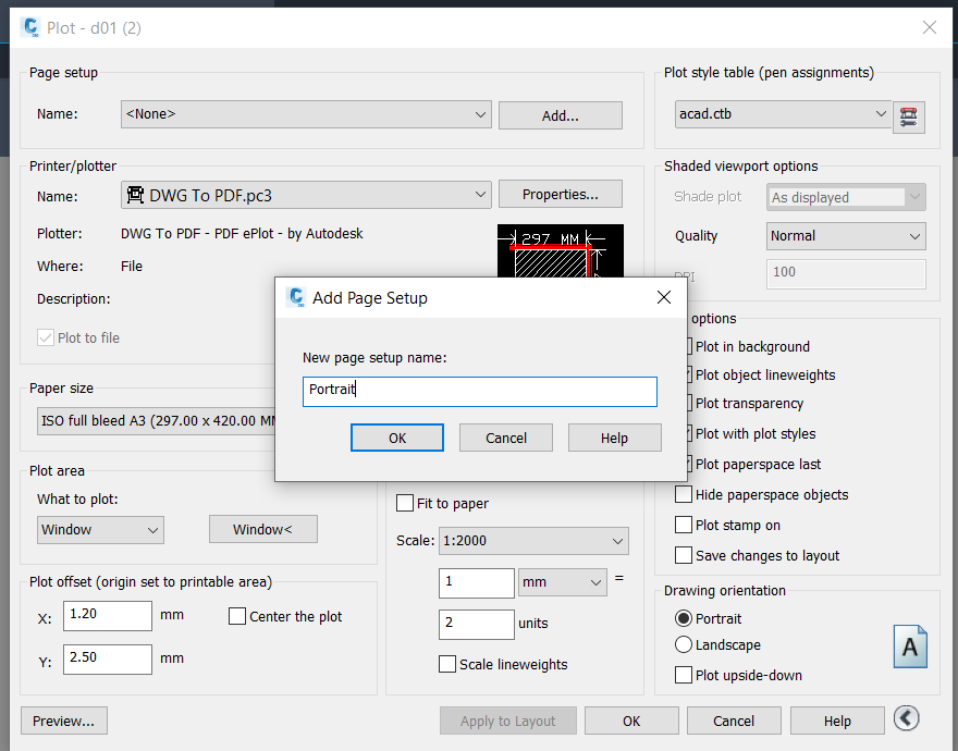

If you want to continue down the publish portrait landscape path you need to save the plot settings for each layout so would have 2 landscape and portrait. Once setup you can click on Name top right and select correct one.

You only need to make each correct plot settings in your DWT saving the plot settings for each type of layout using the Apply to layout button then ADD button then when all done select cancel it will remember the last setting also. You can also pull the settings out of another dwg.
