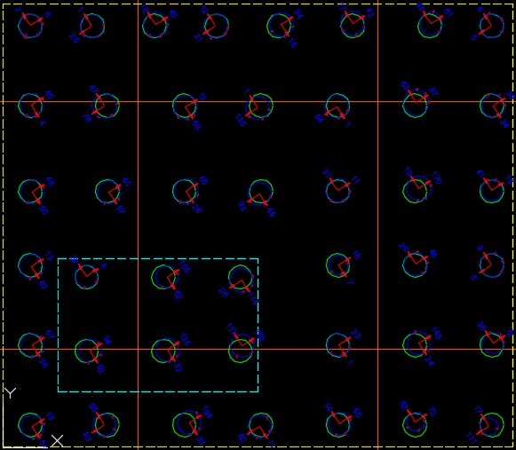

Costinbos77 Posted September 7, 2020 Author Posted September 7, 2020 (edited) Quote ... you have built in CIRCLE command with 3P (3 point) option, so you can directly draw circle through command usage... ... Good point marko_ribar ! But I think will be slow for 500 circles or more . This is the result : I need the center of the circle defined by 3 points and compared with the center of the designed one. So , I reduce the values if are bigger then 100,000 : (setq selP nil selP (ssGet '((0 . "Point"))) ) ; Select only 3 points ! (if (and (setq e0 (ssName selP 0)) (setq e1 (ssName selP 1)) (setq e2 (ssName selP 2)) ) (progn (setq p1 (trans (cdr (assoc 10 (entGet e0))) 0 1) p2 (trans (cdr (assoc 10 (entGet e1))) 0 1) p3 (trans (cdr (assoc 10 (entGet e2))) 0 1) ) ;;; (setq p1 (cdr (assoc 10 (entGet e0))) p2 (cdr (assoc 10 (entGet e1))) p3 (cdr (assoc 10 (entGet e2))) ) (if (and p1 p2 p3) ; Locale (progn ;;; (setq x1 (/ (car p1) 1000.) y1 (/ (cadr p1) 1000.) x2 (/ (car p2) 1000.) y2 (/ (cadr p2) 1000.) x3 (/ (car p3) 1000.) y3 (/ (cadr p3) 1000.) (setq x1 (car p1) y1 (cadr p1) x2 (car p2) y2 (cadr p2) x3 (car p3) y3 (cadr p3) ) (if (or (> x1 100000) (> x2 100000) (> x3 100000) ) (setq x0 (* (fix (/ (min x1 x2 x3) 1000.)) 1000.) x1 (- x1 x0) x2 (- x2 x0) x3 (- x3 x0) ) (setq x0 0) ) ; if (if (or (> y1 100000) (> y2 100000) (> y3 100000) ) (setq y0 (* (fix (/ (min y1 y2 y3) 1000.)) 1000.) y1 (- y1 y0) y2 (- y2 y0) y3 (- y3 y0) ) (setq y0 0) ) ; if (setq a (* (+ (* (- y2 y3) x1) (* (- x3 x2) y1) (* x2 y3) (* x3 y2 -1.) ) 2.) x (+ (/ (+ (* (+ (* x1 x1) (* y1 y1)) (- y2 y3)) (* (+ (* x2 x2) (* y2 y2)) (- y3 y1)) (* (+ (* x3 x3) (* y3 y3)) (- y1 y2)) ) a) x0) y (+ (/ (+ (* (+ (* x1 x1) (* y1 y1)) (- x3 x2)) (* (+ (* x2 x2) (* y2 y2)) (- x1 x3)) (* (+ (* x3 x3) (* y3 y3)) (- x2 x1)) ) a) y0) ;;; x (* x 1000.) y (* y 1000.) dX (- (+ x0 x1) x) dY (- (+ y0 y1) y) r (sqrt (+ (* dX dX) (* dY dY))) ) ; s (entMake (list '(0 . "Circle") (cons 8 "Lay1") '(6 . "ByLayer") '(62 . 256) (cons 10 (trans (list x y 0) 1 0) ) (cons 40 r) ) ) ; end of e ) ; prog then (prinC "\n NO 3 VALID Points ;") ) ; if )) ; if and At the moment , it is working like that . will see next . 3.13 Dev C.mp4 Regards, Costin Edited September 7, 2020 by Costinbos77 Quote

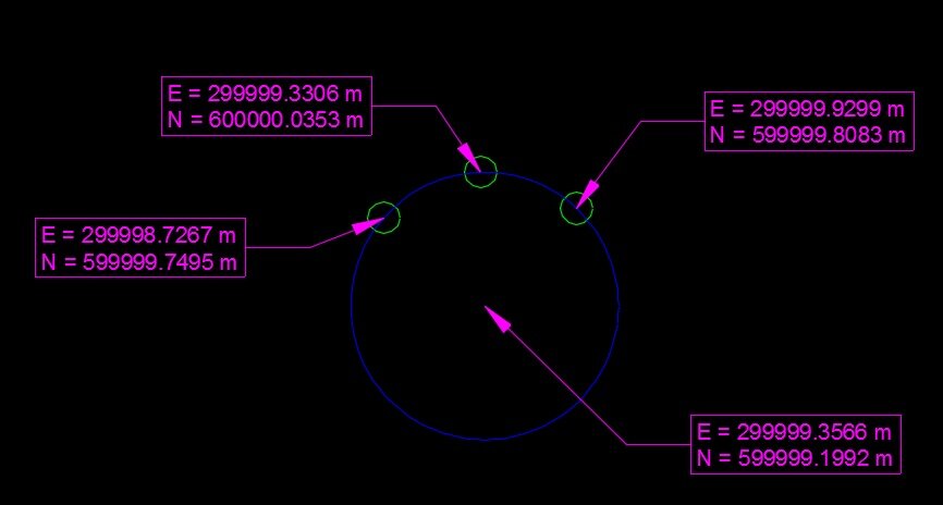

Costinbos77 Posted September 8, 2020 Author Posted September 8, 2020 (edited) Hi Stefan BMR , Formulas , are fine and are working with any coordinates (see the bottom coordinates from video) . 3.13 Dev C 3.mp4 It is not a perfect solution , but , for my needs it is perfect ! It is important to work in the Origin (0 0 0) for UCS and somewhere between 300,000.0 - 600,000.0 ( national coordinates system ). The radius of circles will not be bigger than 1.5 m . My solution will have a problem when some values of coordinates will be below 100,000.0 and others will be above of 100,000.0 , which is not my case . This is why I changed the test from (> x1 100,000.0) to (> x1 100,005.0) . I don't know exactly the limit , but I know the values as 100,006.0 , are working fine . An UCS around the working area , will drop down the values of coordinates and will be no problems with big numbers in formulas . Regards , Costin Edited September 8, 2020 by Costinbos77 Quote
Stefan BMR Posted September 8, 2020 Posted September 8, 2020 So, it's not a problem with big numbers. Using the correct formula you can get the circle you need. Look at the sample below. That tiny difference in "a" value is really important for big numbers . For small numbers, it's not, but I don't get it, if you know the formula is wrong, why not change it? X1 299999.929857717 Y1 599999.8083234681 X2 299999.3306365923 Y2 600000.0352543053 X3 299998.7266854801 Y3 599999.749548545 (setq a (* (+ (* (- y2 y3) x1) (* (- x3 x2) y1) (* x2 y3) (* x3 y2 -1.) ) 2.)) (rtos a 2 16) -> 0.6165771484375 (/ x1 a) -> 486557.0 (setq a (* (+ (* (- y2 y3) x1) (* (- y3 y1) x2) (* (- y1 y2) x3)) 2.)) (rtos a 2 16) -> 0.6165121169469785 (/ x1 a) -> 486608.0 Quote
Costinbos77 Posted September 8, 2020 Author Posted September 8, 2020 Stefan BMR , the formulas are right ! Use the above code lines , and you will have the same results . Regards , Costin Quote
Stefan BMR Posted September 9, 2020 Posted September 9, 2020 Well, you are right, both formulas are the same, the terms are just rearranged! In this case, I guess the magnitude of the partial terms makes the difference. In "a" expression, (* (- y2 y3) x1) is in the same range as x1 and (* x2 y3) is 10^6 bigger, which leads to a tiny difference. With your formula in WCS, the circle is always off. With the other formula, I had no errors in my tests. Quote
