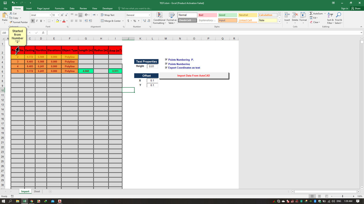

I faced problem with VBA code, I want to start numbering as 1 from the third cell but it's started from number 2 ?!

BIGAL
If you wrote the code then you should be able to work out what is wrong or did some one else do it ? It looks like some forms are being called.
Ok
1 need image showing what is wrong.
2 need xls with macro in it.
Again I am no expert in VBA.
  • Thanks 1

BIGAL
As I already guessed look at your row numbers you have row 1 as a blank line so row3 -2 if want a 1. Its a case of finding that rn-2 position. Not sure why row 1 is blank but that may be harder to fix. Can test is A1 blank A2 blank etc and subtract correct row number.
I think its in this line
p2(0) = P1(0) + Sheet62.TextBox2.Text: p2(1) = P1(1) + Sheet62.TextBox3.Text: p2(2) = 0: Cells(rn, 2) = rn - 1: Cells(rn, 3) = P1(0): Cells(rn, 4) = P1(1): Cells(rn, 5) = P1(2):

sanju2323
Hi Elias,
   You need to change some lines below, hope your issue is resolved.
'Replace line
If Sheet1.CheckBox2.Value = True Then tex = "P. " & rn - 1 & Chr(10) & tex
If Sheet1.CheckBox6.Value = True Then tex = rn - 1 & Chr(10) & tex
'with
If Sheet1.CheckBox2.Value = True Then tex = "P. " & rn - 2 & Chr(10) & tex
If Sheet1.CheckBox6.Value = True Then tex = rn - 2 & Chr(10) & tex
'Replace line
p2(0) = P1(0) + Sheet1.TextBox2.Text: p2(1) = P1(1) + Sheet1.TextBox3.Text: p2(2) = 0: Cells(rn, 2) = rn - 1: Cells(rn, 3) = P1(0): Cells(rn, 4) = P1(1): Cells(rn, 5) = P1(2): Cells(rn, 6) = jeenee
'with
p2(0) = P1(0) + Sheet1.TextBox2.Text: p2(1) = P1(1) + Sheet1.TextBox3.Text: p2(2) = 0: Cells(rn, 2) = rn - 2: Cells(rn, 3) = P1(0): Cells(rn, 4) = P1(1): Cells(rn, 5) = P1(2): Cells(rn, 6) = jeenee

Elias
Your solution was very helpful, truly Bro you are a genius
