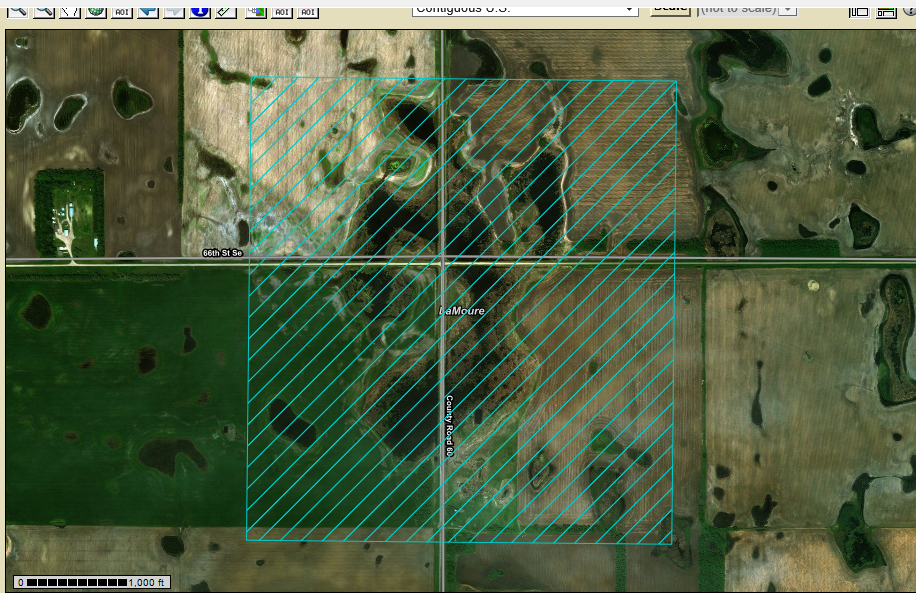

Tharwat
Is this what the outcome should look like?
