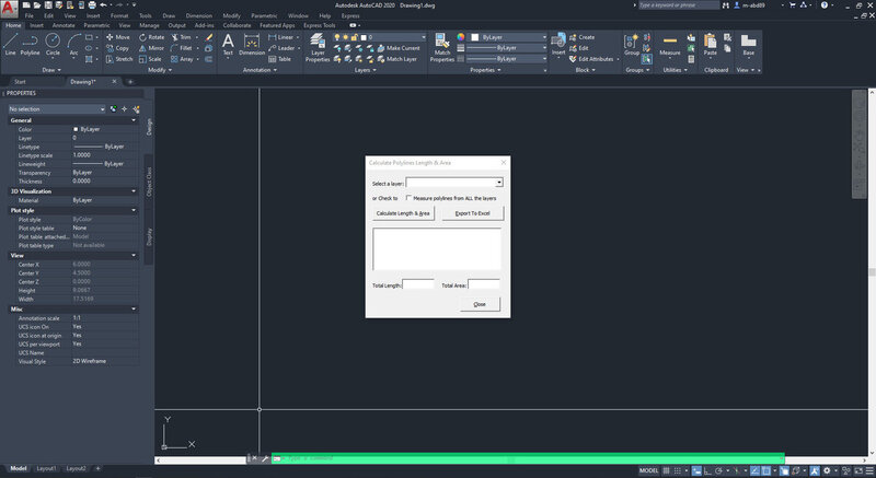

Elias Posted September 26, 2020 Share Posted September 26, 2020 (edited) I need a code that can help me to select all the objects like ( Polyline, 3D polyline, line, Arc, Points etc...) because I can't do anything when I run The VBA program. Thanks Edited September 26, 2020 by Elias Quote Link to comment Share on other sites More sharing options...

Elias Posted September 26, 2020 Author Share Posted September 26, 2020 (edited) Thanks Sir, But I need the code for AutoCAD VBA Source (.dvb) program, for example I have code that can help me to export coordinates of the polyline but the problem which I faced I can't select specific object it export all in the same time. Edited September 26, 2020 by Elias Quote Link to comment Share on other sites More sharing options...
