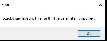

Chudwick Posted October 12, 2020 Author Share Posted October 12, 2020 Here is the error i get trying to open any version of CAD through the remote desktop software. I'll make a real effort this week to get my PC upgrade to windows 10. Quote Link to comment Share on other sites More sharing options...
SLW210 Posted October 12, 2020 Share Posted October 12, 2020 Everything I see for that error, you need to update the graphics drivers for one or more of the computers. What graphics cards do you have? Quote Link to comment Share on other sites More sharing options...

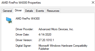

Chudwick Posted October 12, 2020 Author Share Posted October 12, 2020 (edited) this is the card on my work PC. Edited October 12, 2020 by Chudwick Additional info Quote Link to comment Share on other sites More sharing options...
SLW210 Posted October 13, 2020 Share Posted October 13, 2020 Seems the error is ATI graphics card/driver related. I run NVidia cards myself and that would be my recommendation for you. Possible fixes, but check with your IT...https://www.guidingtech.com/fix-loadlibrary-failed-with-error-87-windows-10/ https://superuser.com/questions/1516486/windows-10-loadlibrary-failed-with-error-87-on-remote-desktop-session Some YouTube videos available for the .dll repair as well. Some have seen where 2 graphics card were installed causing this error as well. 1 Quote Link to comment Share on other sites More sharing options...
Chudwick Posted October 13, 2020 Author Share Posted October 13, 2020 Nice detective work, I appreciated the assistance! I did a few searches on the error and found it was graphics related but specifically an ATI issue. I know that this machine has some on-board generic graphics, I think i'll disable that so it doesn't show up in device manager. Will have to check my home PC I can't remember if the motherboard came with a generic and if I had disabled it or not. And yep the comments under one of your provided links show another disabling the generic intel (R) HD Graphics card and his issue went away. Will check this at home, disable it if my mother board came with some generic option and hope its not the .dll thing as I tried to change that, but IT has that portion locked down, we have the ability to install programs, but probably a good thing we can't mess with dlls. Quote Link to comment Share on other sites More sharing options...
Chudwick Posted October 13, 2020 Author Share Posted October 13, 2020 Confirmed, disabling that additional on board graphics card allows Civil 3D to open through the Remote Desktop application. Thank you all for the assistance. 1 Quote Link to comment Share on other sites More sharing options...
SLW210 Posted October 14, 2020 Share Posted October 14, 2020 No problem. I have seen this on other forums before and decided to get to the bottom of it, it affects more than AutoCAD it seems, glad it's sorted. You may still want to get IT to look into the .dll just in case. Quote Link to comment Share on other sites More sharing options...
