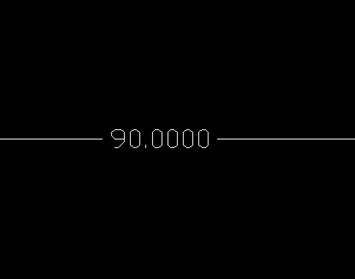

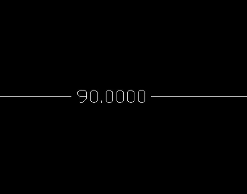

Berzerker
Here's what He said that made me think it may have been him that edited the dimension.
4 hours ago, daveCAAAAAD said:
for example a measurement that should read 90mm I have entered as 0.090.
You don't enter a dimension, you place a dimension.  I don't know if He typed (drew the object at .090mm) when he was drawing it or edited it afterwards. If it was drawn at 90mm it should measure 90mm or dimension at 90mm should I say. There should be no .090mm numbers.
The window thing is just how I see it or explain it. I get the hole in the paper thing now but it just don't fit how I look at it.
I just went and changed to the metric system drew a 90mm line and I get this.
I guess what I'm saying is I don't know if was actually drawn at 90mm to begin with. If it says .090mm then it was drawn at .090mm.
Edited by Berzerker
Share this post
Link to post

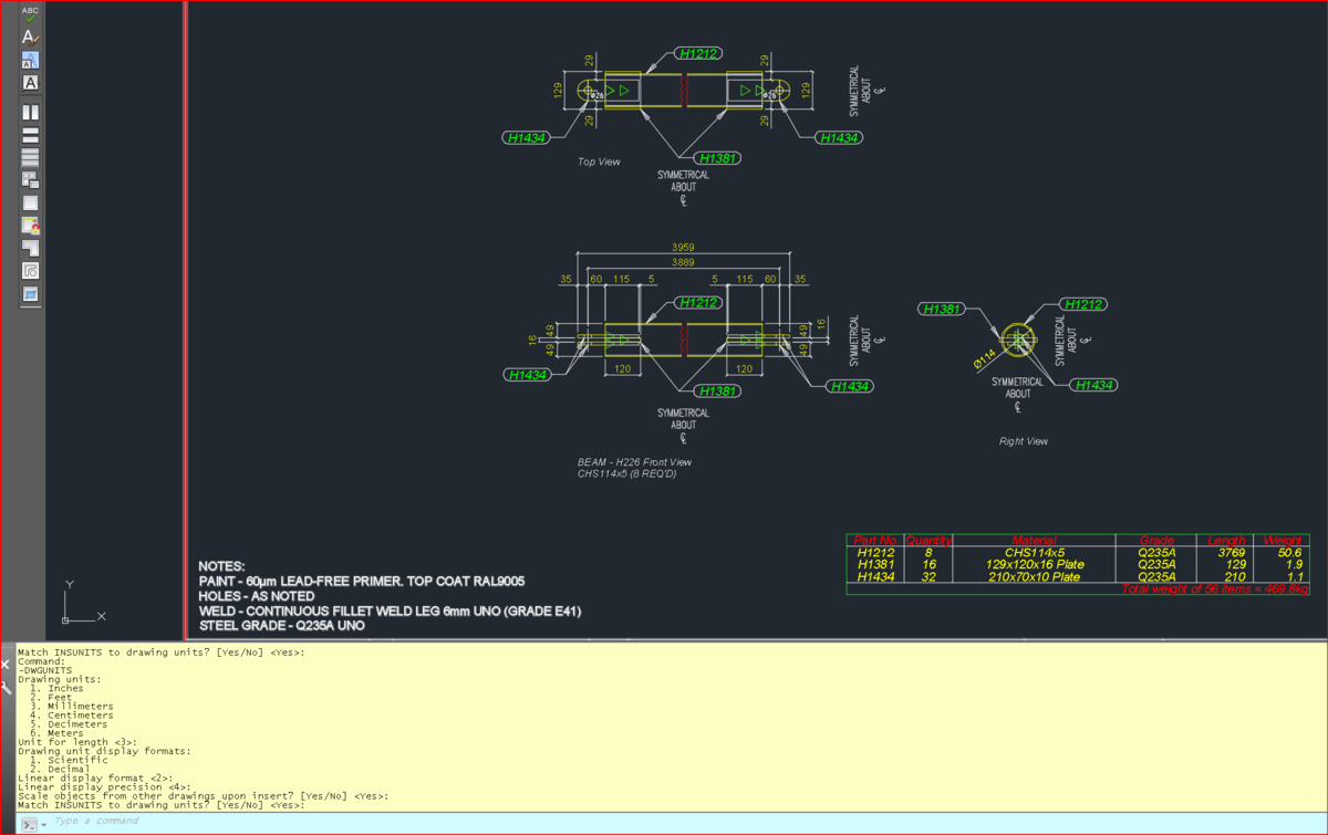

Dadgad
As Dana suggested, and to reinforce what ReMark said.
Should you find yourself working on a drawing, from or by anyone, about which you are curious, the   " -DWGUNITS " command is the way to go.
Ideally, one should set one's default template to reflect the measuring system and units, in which one typically works.
In addition to the issue of Imperial or Metric systems of measure, is the question of what UNITS to work in.
Does a value  of 1 represent one lightyear, one mile, one kilometer, one yard, foot, inch, one meter, one centimeter, one millimeter...you get the picture.
The answer to that question will be supplied by your UNITS value,as you follow the prompts through -DWGUNITS.
Save a copy of your drawing, upon which to experiment with -DWGUNITS.
Expanding your commandline history window to display about 10 lines will help a lot to understand what is going on in the command.
Read the commandline prompts carefully and move slowly through the dialog.
If you run the MEASUREMENT command, the commandline response of <0> means you are working in Imperial, a response of <1> indicates Metric.

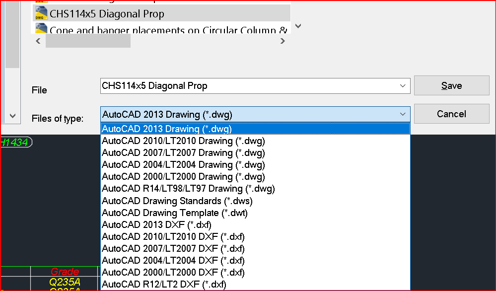

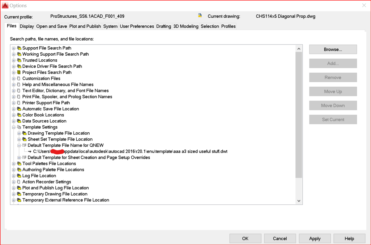

Once you have a completed drawing reflecting all of the values and preferences with which you typically work, use the SAVEAS command, and in the dropdown menu select .DWT, which means you are saving that as a Template, for later use.  See  the last screen shot.
In this dialog you can choose which .DWT to use as your DEFAULT template, every time you start a new drawing, this template will be opened, UNLESS
you actively override it and choose a different .DWT.

daveCAAAAAD
Hi Guys,
I have fixed the problem with the -dwgunits command and checking all dimensions, though I have decided to redraw the whole drawing with some of the pointers as mentioned above, setting the right settings to begin with is a lot easier, thanks everyone for your help its greatly appreciated. might here from some of you when I run into my next problem.

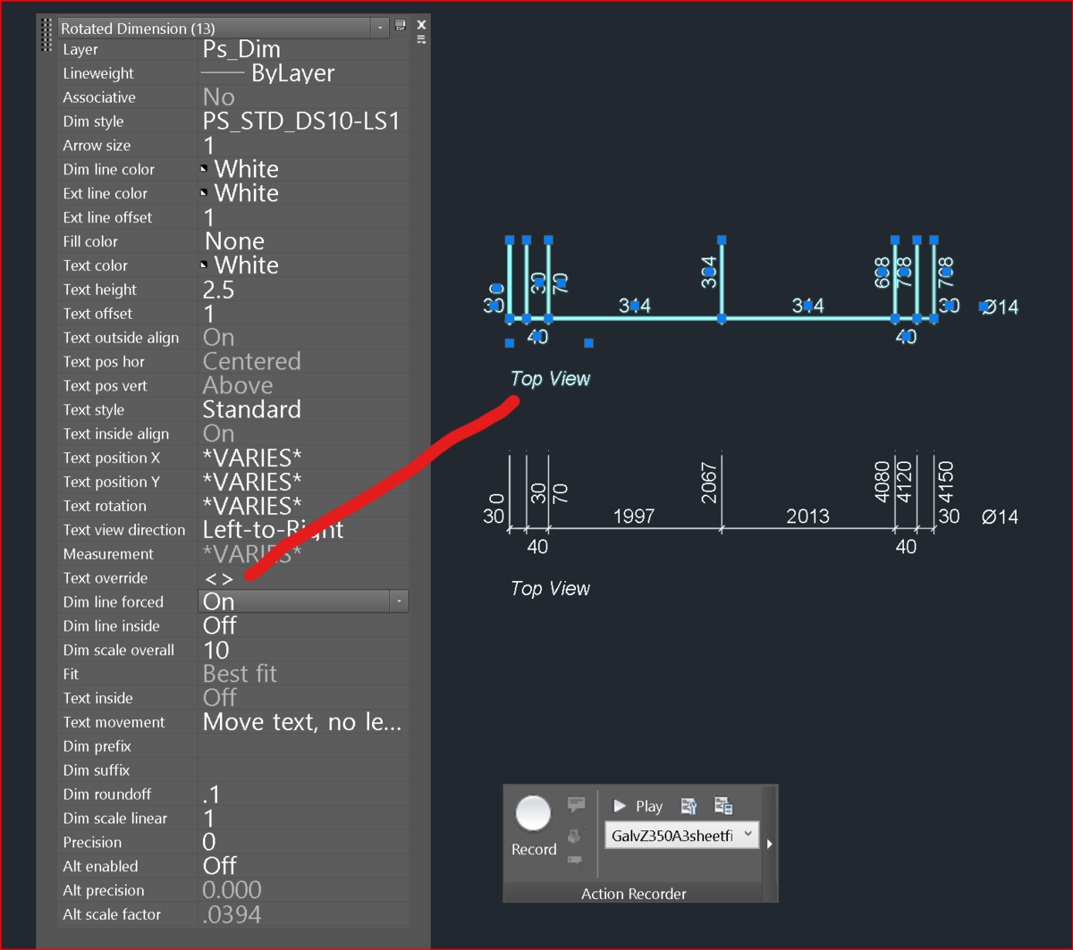

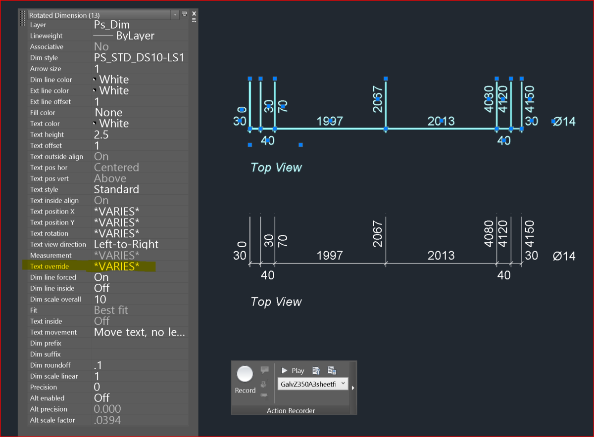

Dadgad
Glad we could help get you back on the tracks.
It sounds like you manually checked all of your dimension.
Much easier to do that in your QuickProperties, as shown.
You can see that in the lower screenshot I have selected one set of dimensions
and entered <> into the Dimension TEXT Override field, which undoes any measurements which you fudged, and makes them display their
true values.  :thumbsup:
