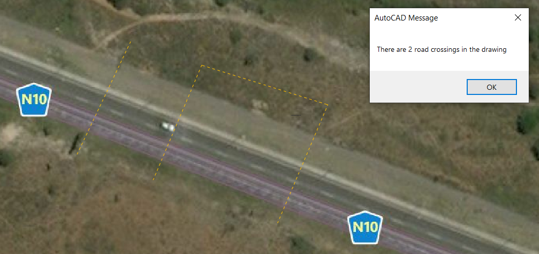

I just realized that if a line/lwpolyline crosses the road two or more times, it will only count it as a single crossing, is there anyway around this?
Here is the full code:

Tharwat
The codes should work and count the crossing LWpolylines / Lines correctly unless the LWpolylines have arcs / bulges that the target objects crossing that arc's limits or lines on Z coordinates other than zero.
If you upload a real drawing where the routine fails then that would help me to take a close look for you.

WHM
Hi Tharwat,
I figured out what the problem was, this routine will select a LWpolyline once even if it crosses the road multiple times.
To address this issue I used @Lee Mac Intersection functions, I just adjusted the SSget filters. The only problem I hit was when a have a large dataset (1200 roads and 5000 LWpolylines) it took almost 4 hours to process the selection sets.
With the initial program, I can filter the LWpolyline selection set based on if it crosses a road. From there the info gets fed to Lee's code, the processing time went from 4 hours down to 11 minutes!
Have a look:
