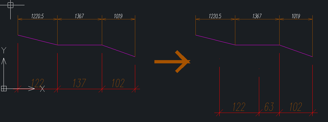

Hi!
In a drawing with many rows of dims (horizontal, vertical, diagonal...) overlapping each other. Is it possible to select linear Dimensions along a line?
Attached file is an example. in which there are many dim lines overlapping each other. Hope you have any solution. Thanks

17 minutes ago, zwonko said:
and nobody gives solution.
Use stretch command. drag a box around dims you want to move or "strech" drag them to new location. But mhupp you can't easily select the dims on an angle like the 3rd option.
use this lisp to twist your model space. two points along the dim that you want to be horizontal. once everything is stretched use dvtw again dont pick anything or enter in 0 and it will return to normal.

stretch is just normal. It is "by hand". If have aby objects on between stretch frame must use layiso to isolate dimlayer only. Also sometimes there are crossing dimensions and once again have to unselect something. Also i have multileaders on same layer. It is just anoying. Of course could be done like that. The worst is not that dims are aligned but that there is always other stuff on stretch frame that must be unselected.
There are so many lisp doing just so simple things that could be done in few clicks. But people making lisp to do it faster.
Lisp which I've linked do nearly what "we" need. I've tried to mod it, to let user unselect other dims but i failed. Also I think that it could be somehow restricted to current zoom windows but don't know how.
Thanks also for the lisp above! It will be helpfull for sure, mainly in other stuff !

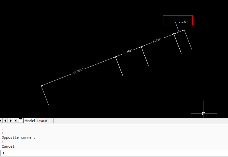

All good wasn't trying to sound mean. This will get you about 80% of what your looking for selecting things. will select all dimensions but the text with leaders isn't (in red)
(defun c:test (/ ent)
  (setq p1 (getpoint "\nSelect Point 1:")
        p2 (getpoint "\nSelect Point 2:")
        ang (angle p1 p2) pi/2 (/ pi 2)
        fuzz 0.001
  (setq SS (ssget "_CP" (list (polar p1 (+ ang pi/2) fuzz)
                        (polar p1 (- ang pi/2) fuzz)
                        (polar p2 (- ang pi/2) fuzz)
                        (polar p2 (+ ang pi/2) fuzz))
                        '((0 . "dimension"))
  (sssetfirst nil SS)
Edited form:https://www.cadtutor.net/forum/topic/17875-how-to-select-objects-that-touch-a-line/?do=findComment&comment=147198

36 minutes ago, zwonko said:
But there is some problem with dims below something. Look on the attached DWG (dims marked RED). Don't know why.
Noticed if you snap to the text of the dimension it would only move the text. is this the problem you are talking about?  was able to move the red dims with out problem.
set osnap to only midpoint so you can quickly pick the midpoint of the dim line and avoid picking the dim text
updated the stretch command to use p2 instead so you don't have to mouse over back to p1
No, it is not that.
Looks like it is ZWCAD problem. On AUTOCAD works perfecly. Some of the red dims move with the attachment points so stretch result can be like here.
image.thumb.png.d2db50eddbaf1062ebd535a995be6cc5.png\
Nut... tried to change fuzz and it works. If fuzz is example 0.1 or 0.01 or 1 is not working properly. For fuzz 2, 5, 7, 20 not working at all (nothing is stretched). For fuzz 10,50,100 works perfectly o_O
