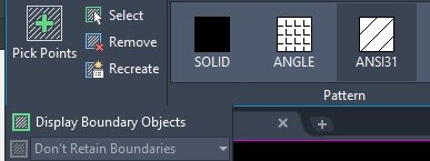

EDIT 2: Another option would be to just select the Hatch and turn on the boundary display! I tested this with the GCEN osnap and it works.
Edited by pkenewell
