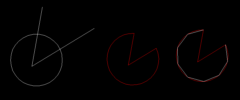

In the case of overlapping objects, if you bpoly the area then you can pull it apart and replace the arcs/bulge with short straights, some one a bit smarter than me may have something I only have the arch 2 chords part. You can pick the pline for the wipeout.
; converts an arc or circle to a series of straights
; By alan H 2012
; info@alanh.com.au
(vl-load-com)
(defun C:arc2chords ( / ss ncrd oldsnap ent endpt obj totlen arclen chrdpt num newpt ang cenpt)
(setq oldsnap (getvar "osmode"))
(if (= ncrd nil) (setq ncrd (getint "\nEnter number of chords: ")))
(setvar 'osmode 512)
(while (setq pt (getpoint "Pick Arc or Circle"))
(setq ss (ssget pt (list (cons 0 "Arc,Circle"))))
(setq obj (vlax-ename->vla-object (ssname ss 0 )))
(if (= "AcDbArc" (vla-get-objectname obj))
(setq  endpt (vlax-curve-getEndPoint obj))
(setq totlen (vla-get-ArcLength obj))
(setq arclen (/ totlen ncrd))
(setq chrdpt (vlax-curve-getStartPoint obj))
(setq num 1)
(command "_Pline" )
(while (= (getvar "cmdactive") 1 )
(command chrdpt)
(repeat ncrd
(command (vlax-curve-getPointatDist obj (* arclen num)))
(setq num (+ num 1))
(command endpt)
(command "")
(if (= "AcDbCircle" (vla-get-objectname obj))
(setq rad (vla-get-radius obj))
(setq cenpt (vlax-safearray->list (vlax-variant-value (vla-get-center obj))))
(setq totlen (* pi (* 2.0 rad)))
(setq ang  (/ (* pi 2.)  ncrd))
(setq chrdpt (polar cenpt 0.0 rad))
(setq num 1.0)
(command "_Pline" )
(command chrdpt)
(repeat ncrd
(command (polar cenpt (* num ang) rad))
(setq num (1+ num))
(command "c")
(setvar "osmode" oldsnap)
(c:arc2chords)

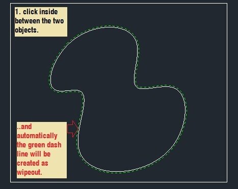

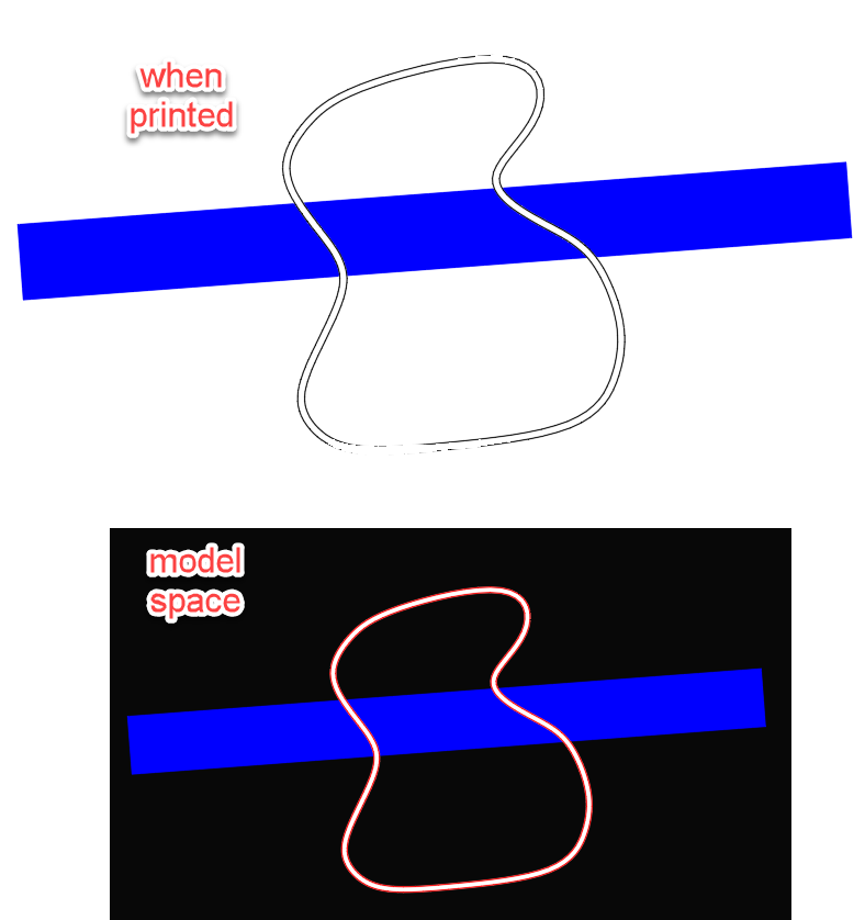

thank you guys....
my apologies, but as per attached is what i want to achieve.
cheers.

mugshot
hello...
its been awhile, i tried sort of thing, but it didnt work.
maybe my description wad blurry.
i found out that what i seeking is BOUNDARY, but instead of a boundary line, it will be automatically a converted to wipeout.
is there a lisp like that?
