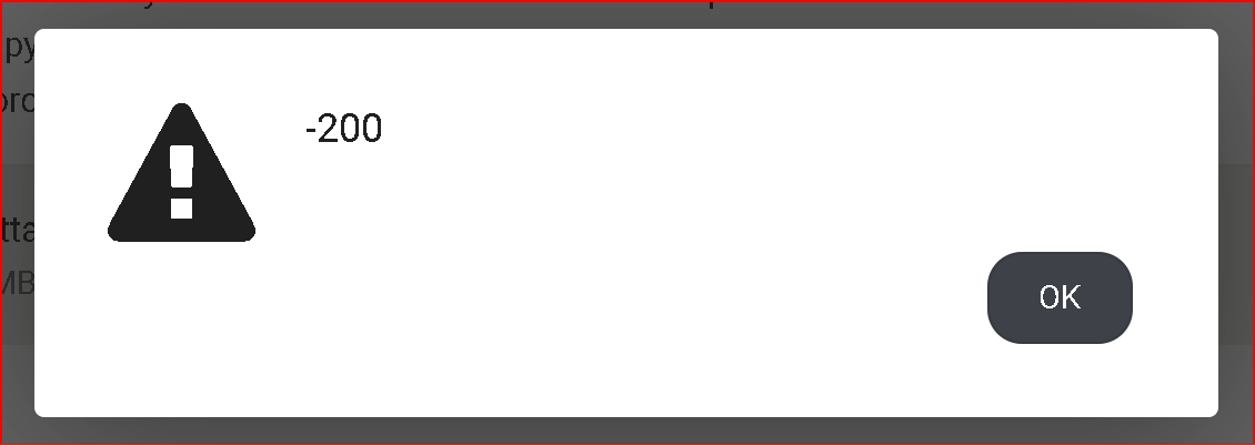

Upload failure message looks like this.
Edited by Dadgad
typos & trying to attach GIF again. 243kb won't attach?

Dadgad
That's too bad.
But thanks for letting me know BIGAL.It was well below the attachment limit?
I must have tried about 4 times, figured I had done something wrong as it was small enough.   :|
Looked like it was and said UPLOADING...until  :nono:  Ah well,sorry it doesn't work.   :beer:
