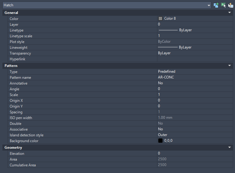

wee Posted November 16, 2020 Share Posted November 16, 2020 I have a drawing that was exported from Revit that has multiple blocks with a hatch background set to a color and I need them all set to none. I can use the blockeditor and do them one at a time but there are over 1000 blocks. Looking for a way to get them all at once. Small example file attached. Thank You Brian block-hatch-fix-.dwg Quote Link to comment Share on other sites More sharing options...

Ajmal Posted July 4 Share Posted July 4 (setq c (vla-get-backgroundcolor o)) (vla-setrgb c 0 0 0) (vla-put-backgroundcolor o C) how can i change to none Quote Link to comment Share on other sites More sharing options...

Ajmal Posted August 13 Share Posted August 13 14 hours ago, ronjonp said: Post an example drawing of before and after of what you're looking for. while I am using this, all hatches will add background 0,0,0. if there is no background colour also will be changed to this I have different Hatch background colours. Someone is true colours someone is index colour and someone is without background colour (none). Need all hatch without background colour (need to set none). but I don't want to change any hatch type, pattern, and general colour. need to change background to none HATCH.dwg Quote Link to comment Share on other sites More sharing options...
ronjonp Posted August 13 Share Posted August 13 (edited) I'm not sure I follow .. the code HERE does that already? Nevermind .. I see what you are saying... let me take a look. Try this version: (defun c:foo (/ a c d) ;; RJP » 2023-08-13 ;; Sets hatch background color in blocks to 'none' (vlax-for l (vla-get-layers (setq d (vla-get-activedocument (vlax-get-acad-object)))) (cond ((= -1 (vlax-get l 'lock)) (vlax-put l 'lock 0) (setq a (cons l a)))) ) (vlax-for b (vla-get-blocks d) ;; This line will only process block definitions (if (= 0 (vlax-get b 'isxref) (vlax-get b 'islayout)) (vlax-for o b (cond ((and (vlax-write-enabled-p o) (wcmatch (vla-get-objectname o) "AcDbHatch")) (setq c (vla-get-backgroundcolor o)) (vla-put-EntityColor c -939524096) (vla-put-backgroundcolor o c) ) ) ) ) ) (foreach l a (vlax-put l 'lock -1)) (vla-regen d acallviewports) (princ) ) Edited August 13 by ronjonp 2 1 Quote Link to comment Share on other sites More sharing options...
