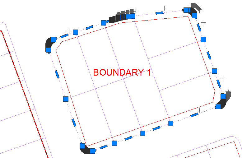

i manually selected (as shown in screenshot) all the lines which need to offset & kept boundary visible in screen,
but i m unable to do that.
@amb2301 You cannot select all the boundaries at once, you just have to select an internal point for each boundary like the HATCH command, then just keep picking internal points until you have all the boundaries. As I said it will loop until you exit by pressing Enter.
NOTE: I don't know of a way to do exactly what you want. There is no way to determine what the inside is for each boundary is by just selecting everything at once.

 i tried selection of boundary like Hatch, but i m getting boundaries inside each lots as shown in below pic,
i need to make boundary as shown in blue tic mark, could you please try with that sample file.
sorry for troubling you
Edited by amb2301
@amb2301 OK - sorry I misunderstood what you wanted. Try this. NOTE: you have to pick an Internal point, then select the OUTER boundary objects of the area. Before you press Enter after selecting the outer objects, make sure you zoom out so all objects for the selected boundary are visible on the screen. This is the best I can do i'm afraid. Perhaps someone else here can come up with something better.
