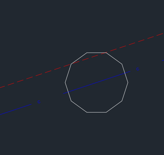

Just an idea not code if you say draw a ploygon at say middle of a pline say 0.6 radius then use that with ssget "F" it will look for something at less that 0.5.
(command "polygon" 10 inst "I" 0.6)
(setq co-ord (mapcar 'cdr (vl-remove-if-not '(lambda (x) (= (car x) 10)) (entget (entlast)))))
(setq ss3 (ssget "F" co-ord (list (cons 0 "LWPOLYLINE"))))

 Would you pick as you guess it is near 0.5 m or want to check along the PLINE , at a given distance ,  and mark where it happen the OFFSET is > 0.5 ?
