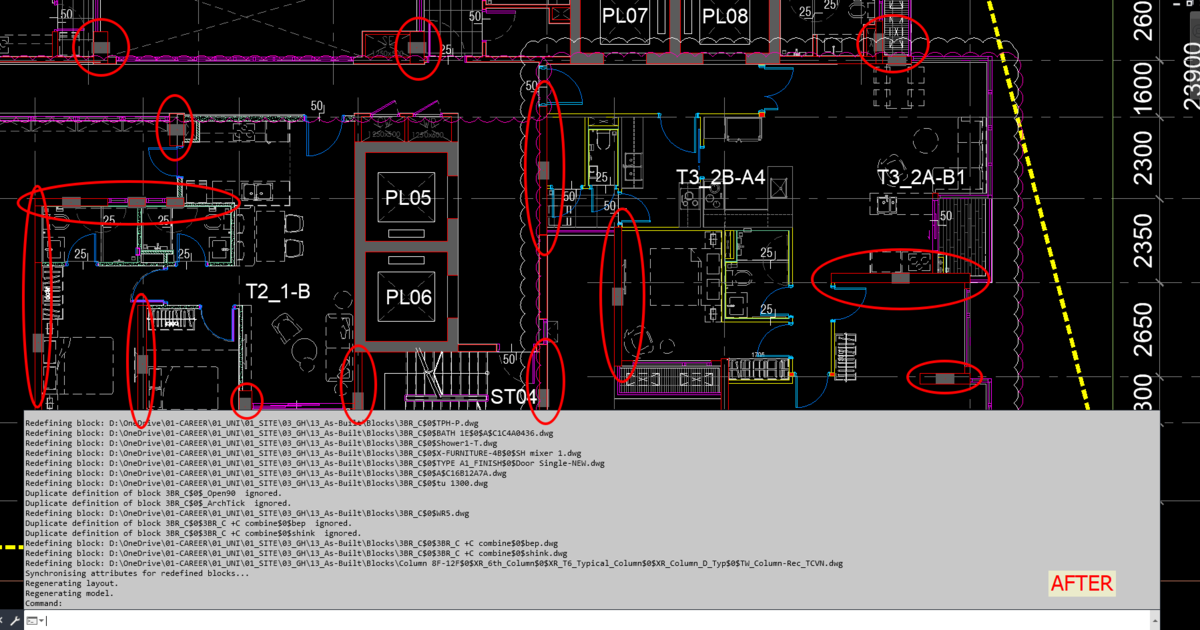

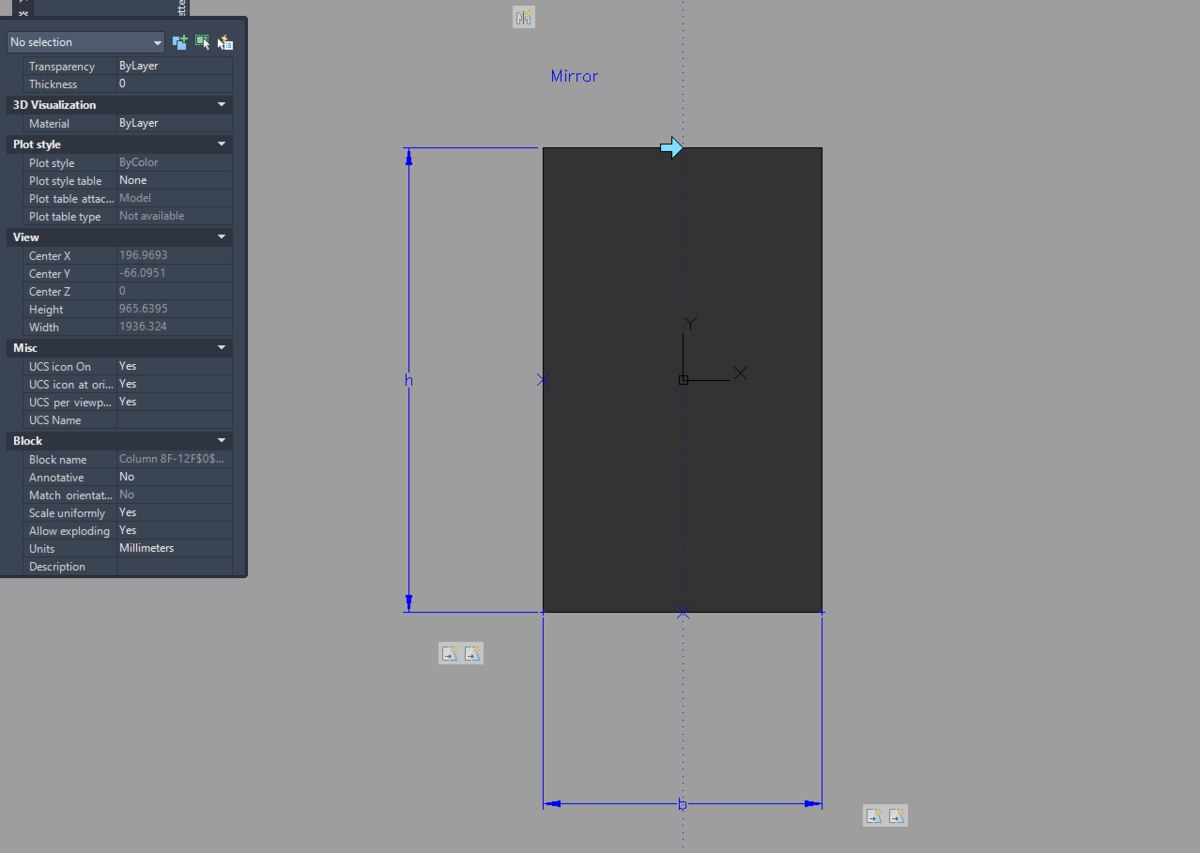

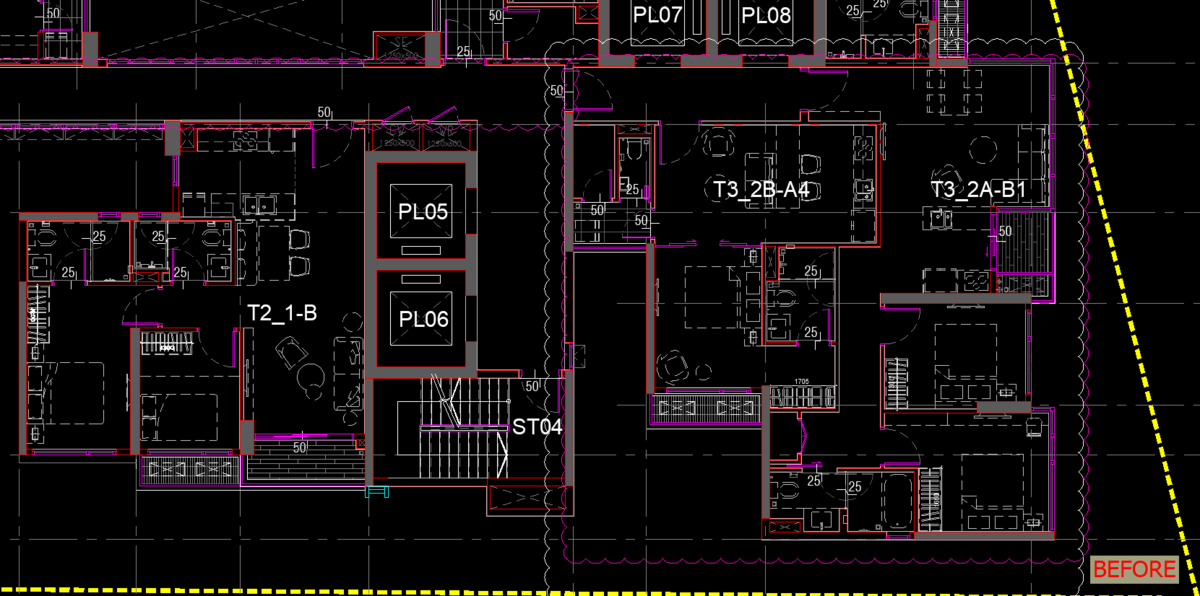

Sorry but I got an issue about attributing block. I have used LEE's "REDEFALL" lisp above but the column block that having solid hatch become smaller as attached images. Please help me!
image.thumb.png.368b8c9d049c85f30a3768b51f4dccfb.pngimage.thumb.png.b59ffdf53d5110ebd3f739000c4f7325.png
Link to post
