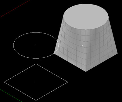

fahim108 Posted July 19, 2007 Posted July 19, 2007 Are you trying to LOFT a square cross-section with a circular one. Just guessing... Quote

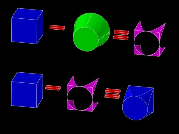

kduck63 Posted July 19, 2007 Posted July 19, 2007 I don't know if acad 2000 has an interference command, but I know you can do a simple subtraction with it. This is made with a regular cube and truncated cone.The cone has a base dia equal to the diagonal of the cubes side and a top dia equal to one side of the cube. Quote
Pocket Posted July 19, 2007 Posted July 19, 2007 It would but then youd have surfaces mixed in with solids Kduck has it Quote

the hat Posted July 23, 2007 Author Posted July 23, 2007 kduck spot on thanks, Why didnt I think of that. Brill Quote
fuccaro Posted July 24, 2007 Posted July 24, 2007 just a small observation Kduck64: If you put the cone and the cube in the right place you may INTERSECT the two solids and you have the result in one step. Quote
kduck63 Posted July 24, 2007 Posted July 24, 2007 I don't know if that particular version of acad has the INTERSECT command, but I do know it has the ability to subtract solids. Quote

hazardman Posted July 28, 2007 Posted July 28, 2007 same as fahim108 i would have lofted the shape...here's a pic of the result...just note that i exploded the solid so you can see the rulled surface.... Quote
