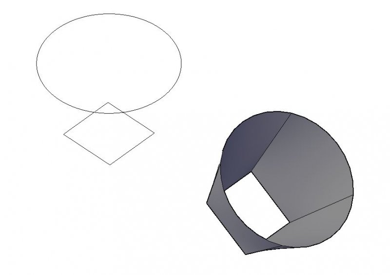

ReMark Posted October 26, 2016 Posted October 26, 2016 Have you tried the LOFT command? I did this with the LOFT command making sure to set the MOde option to SUrface. I tilted the resultant object so you can peek inside. Quote
ProvoZA Posted October 26, 2016 Posted October 26, 2016 Yes ReMark, after much Googling, I tried LOFT and it works great. And it creates a 3D solid instead of a surface. Thanks a mil. Quote
ReMark Posted October 26, 2016 Posted October 26, 2016 The user is free to select whether they want to create a SOlid or a SUface via the MOde option of the LOFT command. Quote
