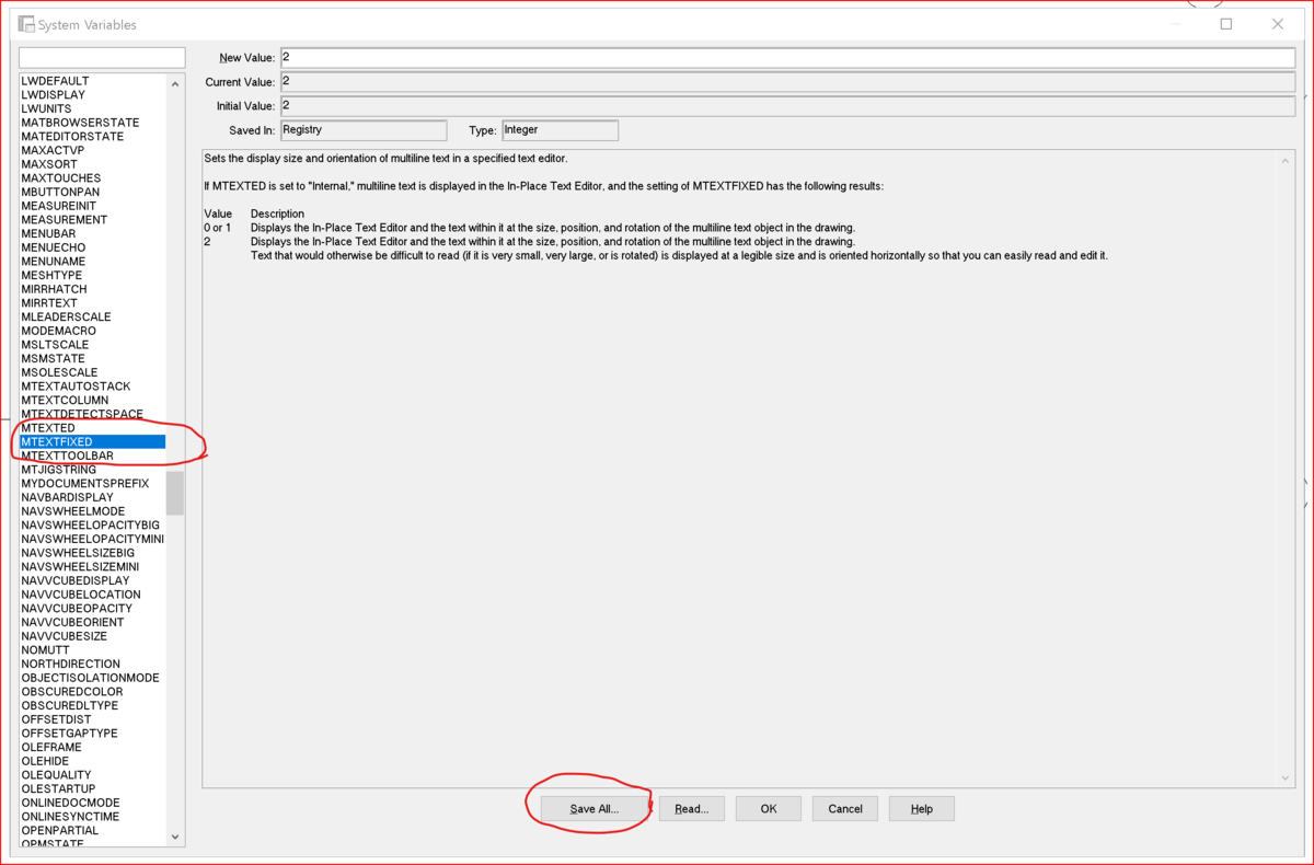

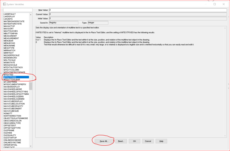

Check your DBLCLKEDIT variable, if Off turn it ON.
It is times like this that makes having a .SVF  (system variable file) tucked away somewhere for safe keeping, as presumably one of your system variables, or more, have gone walkabout.
That .svf file would have all your preferred variable settings ready to restore, or rather READ, in the bottom of your SYSVDLG box.
Turn ON your DBLCLKEDIT, and forget about entering a 6 letter shortcall.  Just double click on it, and start editing.
Once you get back on the tracks make sure you click SAVE ALL at the bottom of the SYSVARDLG

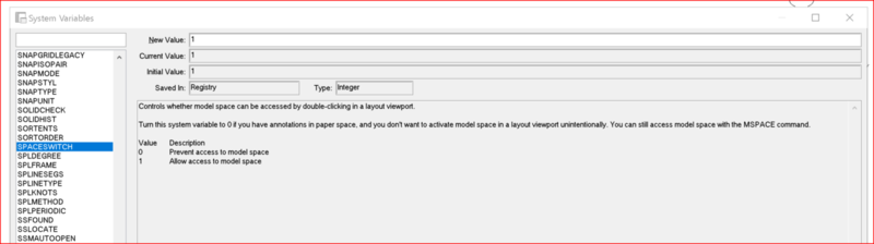

Is someboyd messing with your mind and your variables for a laugh?  Check SPACESWITCH too.

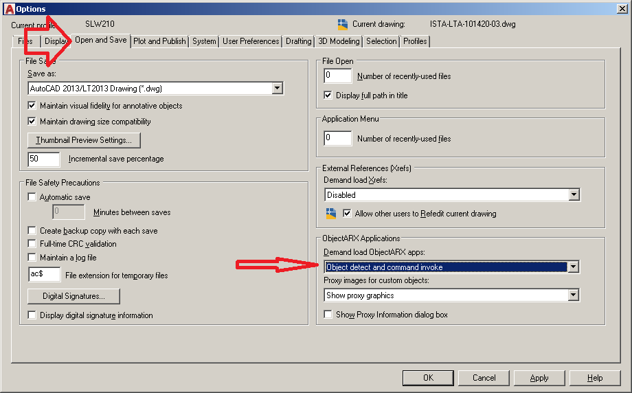

Most likely a change to DEMANDLOAD System Variable, should be 3 IIRC.
Or in Options>Open and Save>ObjectARX apps: Object detect and command invoke
