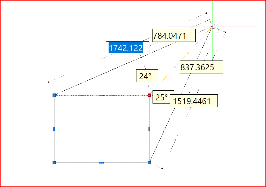

I hope I'm using the correct term here. I need what I call polar tracking enabled in my setup. That is when I highlight a line and hover the mouse over one of the grips it shows me the length and the angle the line was drawn to. From time to time, this stops working on me. So I press F12 which a post I once read said to do or F10 which another post told me to do. What I'm finding is that this is intermittent. I was working with my setup last night and all was well. But today it's disabled again. So I used the OSNAP window to select Polar Tracking On and it's just not working. I hate to reboot everything so is there something I'm missing in this?

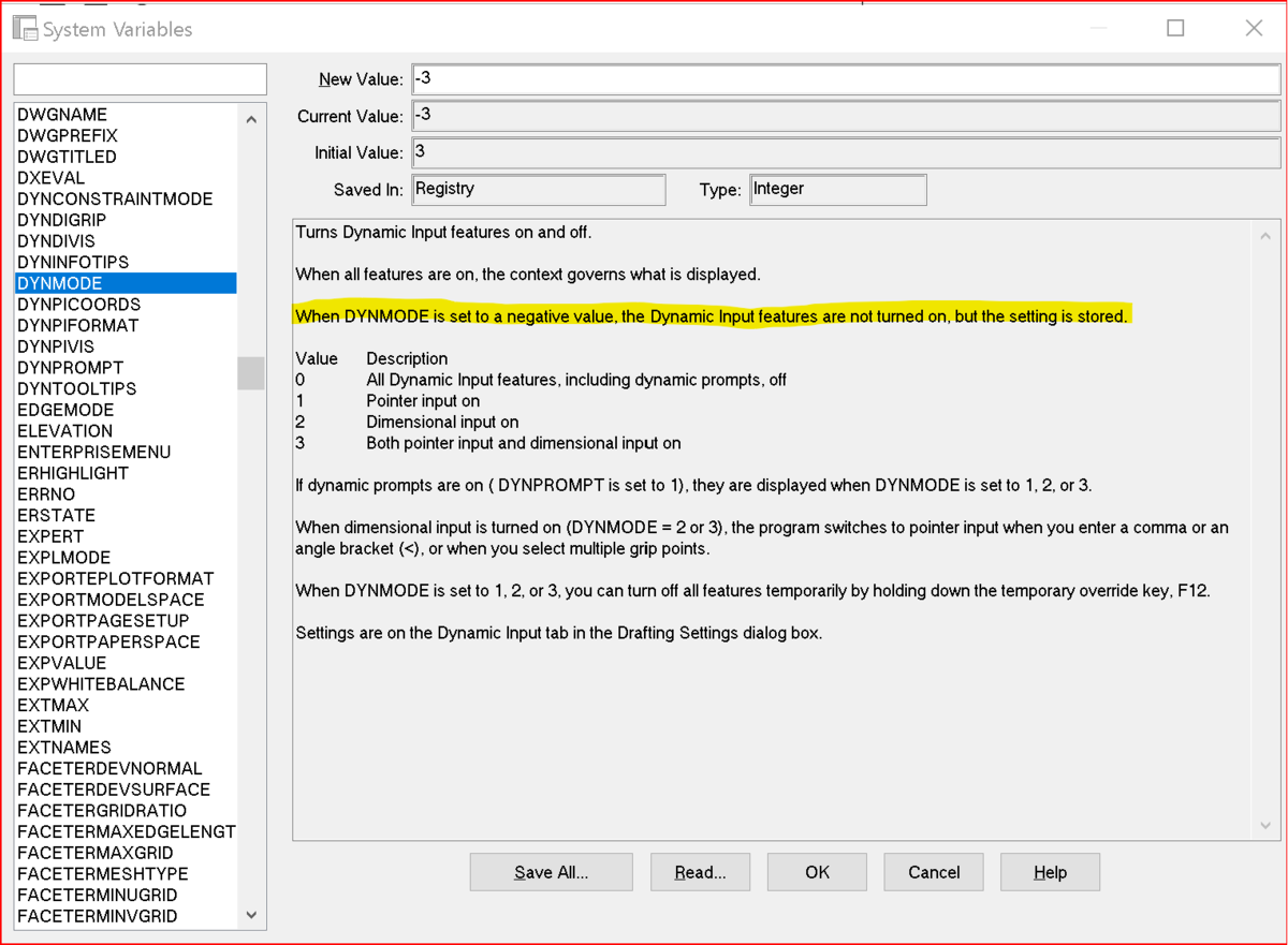

Setting dynmode to 3 took care of it. It was set to -1. But my question then becomes how did if get reset in the first place. And this is not the first time this has happened. Yesterday my cell phone went quiet and I found it sitting there with the Do Not Disturb setting enabled. This is the 3rd time this happened in the last week. Darned if I did it. I had to read up on how to disable it. Yet it went into DND mode thrice in the last week or so. Could it be gremlins?

My own is set to "DYNMODE <-3>"
Not sure what the negative sign denotes.

Looks like the Negative value means you have a setting stored, but Dynamic Input features are not turned on.   :beer:

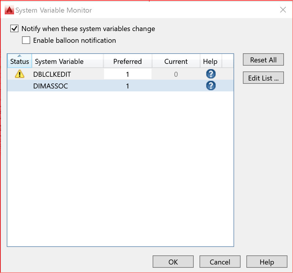

Bill you sound like a good candidate to explore the SYSVARMONITOR functionality.
If you find particular Variable settings changing with annoying regularity, this will display an alert whenever it happens,
after taking a few minutes to set it up how you prefer it.
That will also help you understand what lisps or behavior is triggering the unintended variable changes real time, and easily reset them to your favored usual settings.

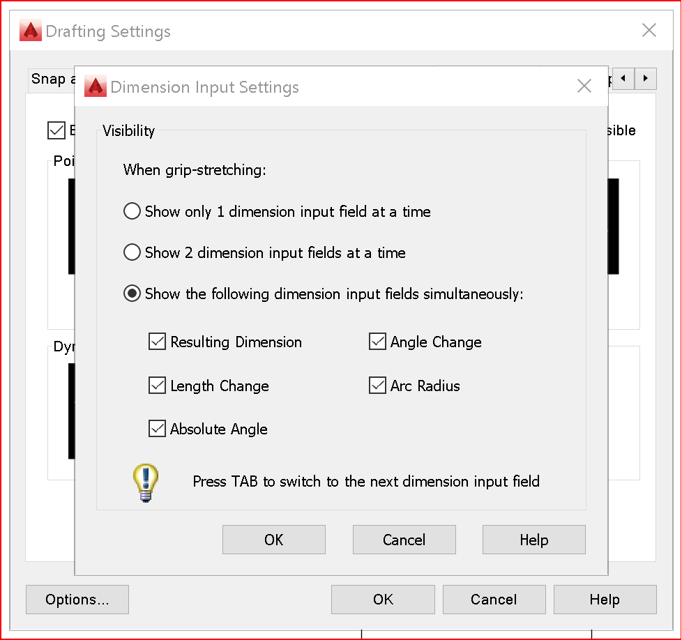

While the following screenshot would likely represent sensory overload for 99.99% of users, as Dynamic Grip Stretch entry fields, there are likely a very few users who would favor
this sort of virtual omniscience/omnipotence.   As is abundantly clear in our software, as in our daily lives; due to the fact that there is access to way more data (good, bad or indifferent) than one could ever need or process, that makes it our responsibility to determine that which is accurate, has relevance and will be of assistance.   :|
