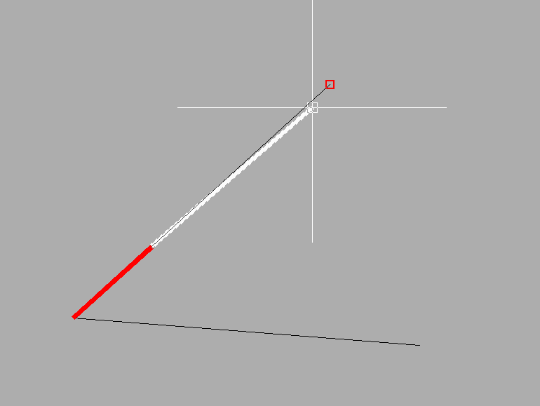

Excuse my GIF making capabilities, this is a little out of my wheelhouse.
Below is a GIF showing what I'm trying to do with a (I think) variable already within AutoCAD. Notice, I'm drawing the lines toward the end point snap but I am NOT snapping to those endpoints. I start at the vertex and draw a line at a certain distance toward the endpoint. Any help is appreciated.
CAD GIF

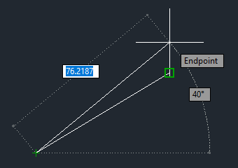

Your description does point at user error, using distance entry will draw in the direction of the cursor NOT to the users idea of where it should draw, the OSNAP highlight is a separate function, each osnap point will highlight at some point when it is the closest point to your cursor (not when it is active), and you need to move the cursor close enough to an osnap so that the cursor snaps to that point (this is controlled by aperture) typing in a distance has to have the cursor locked onto that point and not just floating nearing a green osnap icon

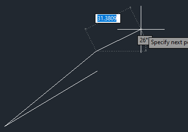

Here is a picture showing the snap activated, the cursor off line, and the line drawn along the line, but to a length input on the keyboard.

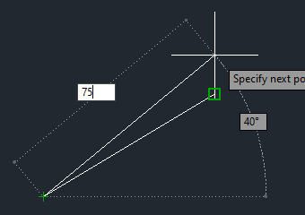

For me the lowest line is the existing line and the endpoint is highlighted, but the cursor is not located at that endpoint.
Entering a distance and pressing enter will draw the line to the cursor position and not to the 'highlighted' endpoint.
Even though the endpoint is highlighted the line is drawn in the direction of the cursor.
However with dynamic input turned off, the behaviour is different, then using keyboard entry for the distance will indeed draw in the direction of the highlighted snap. Could that be the reason for the different user experience.
