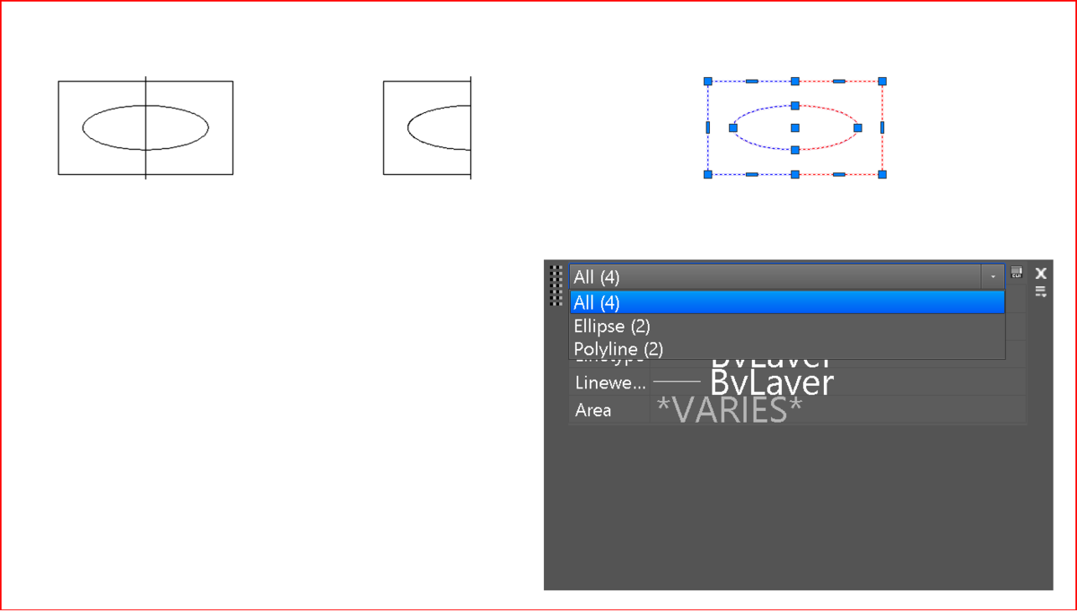

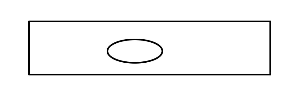

arika Posted December 15, 2020 Author Share Posted December 15, 2020 So Break, divides it, but it leaves only one side and deletes the other side. i need both sides. Just separated. in the attached pic i would like to divide in the middle of the circle and keep both sides. Quote Link to comment Share on other sites More sharing options...
rkmcswain Posted December 15, 2020 Share Posted December 15, 2020 You just need to break the rectangle and the ellipse at two points each. Use the same point (the @ sign) for both points of the BREAK command. Some versions of AutoCAD and otherCAD may have a menu item that assists in Breaking At The Pick Point. An ellipse and circle are kind of unique. You will need to break the first time leaving a gap, then adjust for that afterwards. Quote Link to comment Share on other sites More sharing options...

eldon Posted December 15, 2020 Share Posted December 15, 2020 Draw a line across your break point before you copy, and then trim the excess on each copy. 1 Quote Link to comment Share on other sites More sharing options...
arika Posted December 16, 2020 Author Share Posted December 16, 2020 2 hours ago, eldon said: Draw a line across your break point before you copy, and then trim the excess on each copy. hmm, i think that might work, thanks Quote Link to comment Share on other sites More sharing options...
