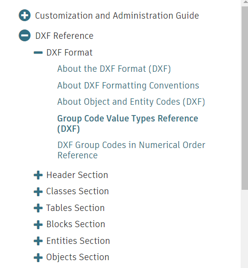

Anyway I wonder where is that tree digging explained. After your suggestion I've reread my DXF reference manual and I haven't been able to find a hint about this. The pdf I looked up though (I realize this now) is Autocat 2012 edition, whereas I am working with Autocad 2020. May be that's why...

My only concern was about documentation where this subject is described. I don't think we, as Autocad users, especially beginners, should explore the DXF entities in a let's say trial and error process to find what one is looking for. I would rather expect to find it in some documentation manual.

For more info or for deeper dives into entities / objects , just entget any object and take the DXF group codes and read about them in the DXF documentation side by side with practicing more and more.
