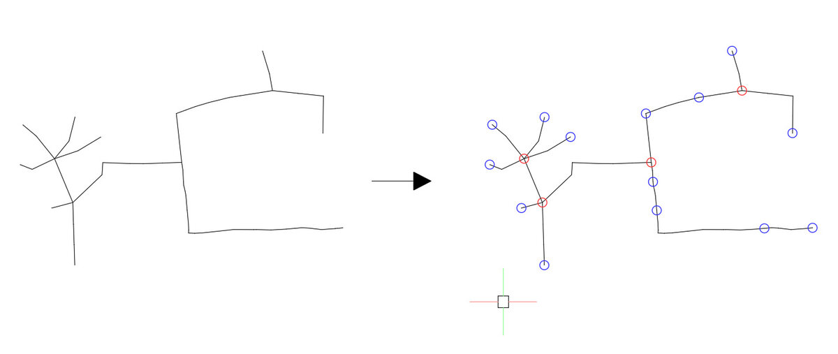

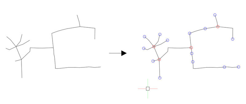

Hi, does anyone have a lisp which I can use for this:
I'm working on a piping network made of polylines. I need to insert circles at the ending/starting points of all polylines (without having multiple circles at the same location).
- The circle has to be blue if: 2 polylines have their start/end overlapping, or if the end/start of a polyline doesn't intersect with any other.
- But when 3 (or more) polylines share the same ending/starting point, the circle should be red.
Example drawing attached.
network fittings.dwg
