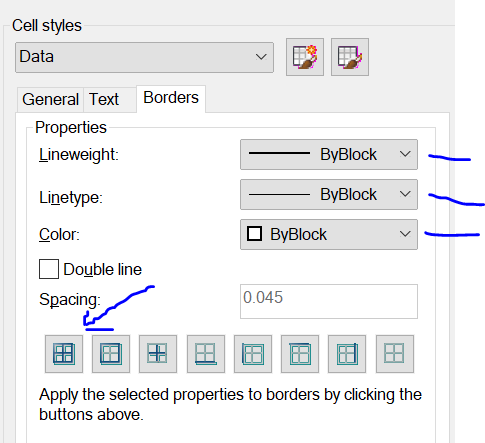

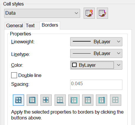

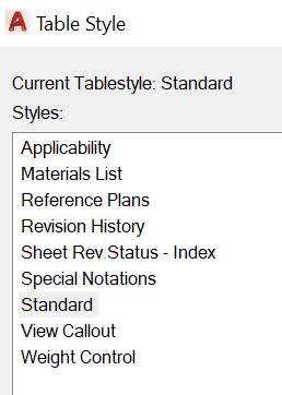

Find all Table Styles in a drawing
change settings under each of the Cell Styles
Under the Borders Tab
Lineweight = ByLayer
Linetype = ByLayer
Color = ByLayer
All Borders

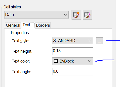

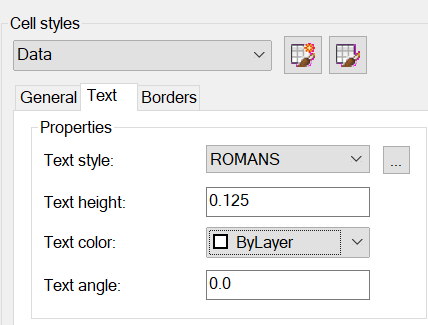

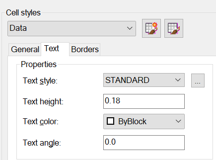

Under the Text tab
Text Style = Romans
Text Height = .125
Text Color = ByLayer
image.png.10057c47e1f77f7ae390516325b4f3f8.png        image.png.fd48a3506b1c1772a768e80329500676.png

Here is step 1 as asked.
(setq tbldict (vla-item (vla-get-dictionaries (vla-get-database (vla-get-activedocument (vlax-get-acad-object)))) "Acad_TableStyle"))
(setq x (vla-get-count tbldict))
(setq tlist '())
(repeat x
(setq tlist (cons (vla-get-name  (vla-item tbldict (setq x (- x 1)))) tlist))
