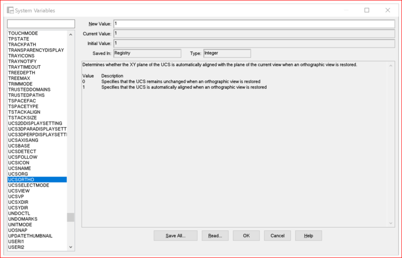

madriver Posted January 18, 2021 Share Posted January 18, 2021 (edited) So some setting has mis aligned my UCS. It is set to world, SNAPANG is set to 0 but when I go to move an object the polar UCS is off angle by a few degrees and won't allow a straight 90 or zero degree move? Also when drawing a line the X axis will draw at 0 degrees but the Y axis will no draw 90 degrees. Thank You Edited January 18, 2021 by madriver Quote Link to comment Share on other sites More sharing options...
Dadgad Posted January 19, 2021 Share Posted January 19, 2021 Could you please post a drawing misbehaving thusly? Quote Link to comment Share on other sites More sharing options...
Dadgad Posted January 19, 2021 Share Posted January 19, 2021 Open your SYSVDLG window and cursor scroll through all of the sysytem variables which begin with UCS, as shown in the screenshot. Might want to check your UCSORTHO variable setting as shown too. Quote Link to comment Share on other sites More sharing options...

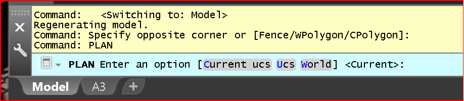

rkent Posted January 20, 2021 Share Posted January 20, 2021 Make sure PLAN is set to World. 2 Quote Link to comment Share on other sites More sharing options...
Dadgad Posted January 20, 2021 Share Posted January 20, 2021 Nice one rkent! Not one with which I was familiar. Can only be called in Modelspace. Quote Link to comment Share on other sites More sharing options...
rkent Posted January 20, 2021 Share Posted January 20, 2021 Thanks Dadgad, I have a key shortcut of two letters to return UCS and PLAN to World. Quote Link to comment Share on other sites More sharing options...
