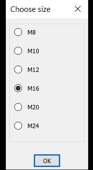

BIGAL
This may be useful its a Library routine can use in any code will make a dcl on the fly for you. You would just run it twice the second time would be for hole type. I dont have it yet but an image version is possible. Same as 2 columns are on the wish list. Would just need 2 lists.
(if (not AH:Butts)(load "Multi radio buttons.lsp")) 		; loads the program if not loaded already
(if (not but)(setq but 1)) 				; this is needed to set default button
(setq siz  (ah:butts but "V"   '("Choose size " "  M8" "  M10" "  M12" "  M16" "  M20" "  M24")) )
(setq hole  (ah:butts but "V"   '("Choose size " "  SITE" "  SHOP" "  HID" "  CTSK" " ELEV" "  SLOT")) )
What you can do is loop through your keys RbX and check if clicked so return the item number of a list rather than checking each button individually, look at "BUT" so no need to hard code the do what as it will match a list that is passed to the routine. (nth but butlst) then use a cond.  Remove the (setq siz and last ) and look at (nth but  butlst)

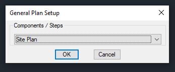

rcb007
Interesting. Thank you for sharing that idea.
I was modifying the DCL to a shape that i think would work. I am hopeful that i would not need to modify the DCL anymore.
Within the Lisp, I am hoping that I could just modify the List Contents. That way, the List in the DCL will automatically read it from the lisp.
I am still trying to figure out how to activate a command when the user selects an option, then hits the OK button to execute it.

rlx
(defun C:samp5  ( / siz names dcl_id userclick drv hole )

  (action_tile "selections" "(setq userclick $value)") ;<------ catch action from popup_list
  (action_tile "cancel" "(setq userclick nil)(done_dialog 0) ")
  (action_tile "accept" "(done_dialog 1)")
  (setq drv (start_dialog))
  (unload_dialog dcl_id) ;unload
  (if (and userclick (= drv 1)) (alert (nth (atoi userclick) names))) ;<---- if there was a userclick and user clicked ok use return value from popup_list as index

rcb007
Thank you, thank you. I placed the other routines within it and it works just like I was envisioning it too.
