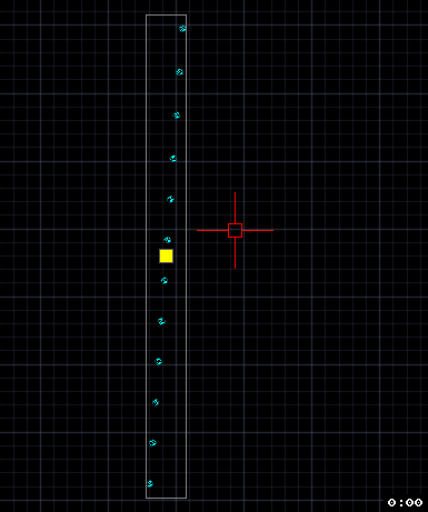

could someone help me and make a lisp in which after selecting the group gives alligned dim beetwen group entities?
The best will be also if I can select group and afer select place where the dim line is going. Also if it is not so hard want it to go to sepparated layer called for example "dim_help", which will be in some colour (example)  and not printable.
The group consinst of blocks, blocks are circle with solid hatch; so the lisp shoud catch insertion point or center of circle.

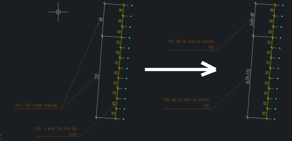

This is why I've thought it will be much easier to be made on two lisps. Let's get it, that group consist of the elements in different spacing
1)   first lisp - first lisp will be help, the lisp is giving me dimensions and show where the pattern (spacing) change.
2)  do manualy - create dimension in beetwen pattern change (for example in the picture below there will be 120 and 48)
3)  second lisp form the second post (
This 1sttest lisp, which You did, is doing the job, but like you said there is the problem that spacing are not the same on group. For me the first thing (makeing dimension with spacing) is much more faster than second thing. First thing is just making spacing dimensions one by one or sometimes even few, if i know where the place of change spacing is. The second thing, make overide on fullDIM is more complicated, must take some calculator (and this is most annoying), calculate fullDIM/spacing, click on full dim, overide its dimtext.

@Tharwat that's look to what I've ment. For this animation, I see, that there is no option to click where the dimension line is going (I wan't to control where it going, otherwise it can go to other object, near the group).
