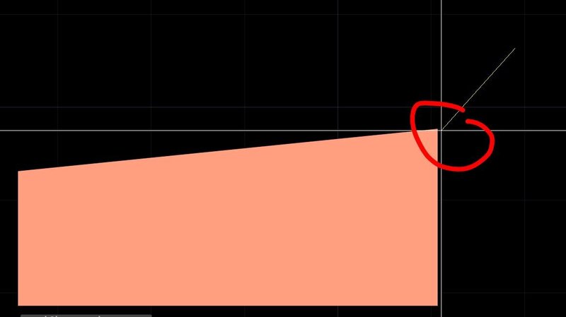

1) I drew a particular shape
2) inside I drew a hatch
3) I accidentally deleted all lines of the particular shape
4) how should I proceed to perfectly draw the hatch boundaries since the hatch grips do not attract the lines?

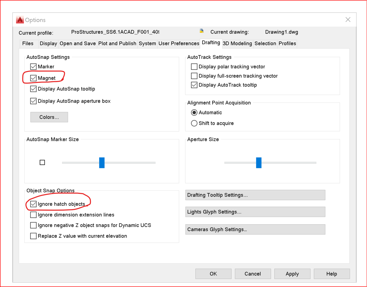

Or go into your OPTIONS and TURN ON  your MAGNET
and UNCHECK IGNORE HATCH OBJECTS on the DRAFTING tab.
Remember to click on OK after you do it.

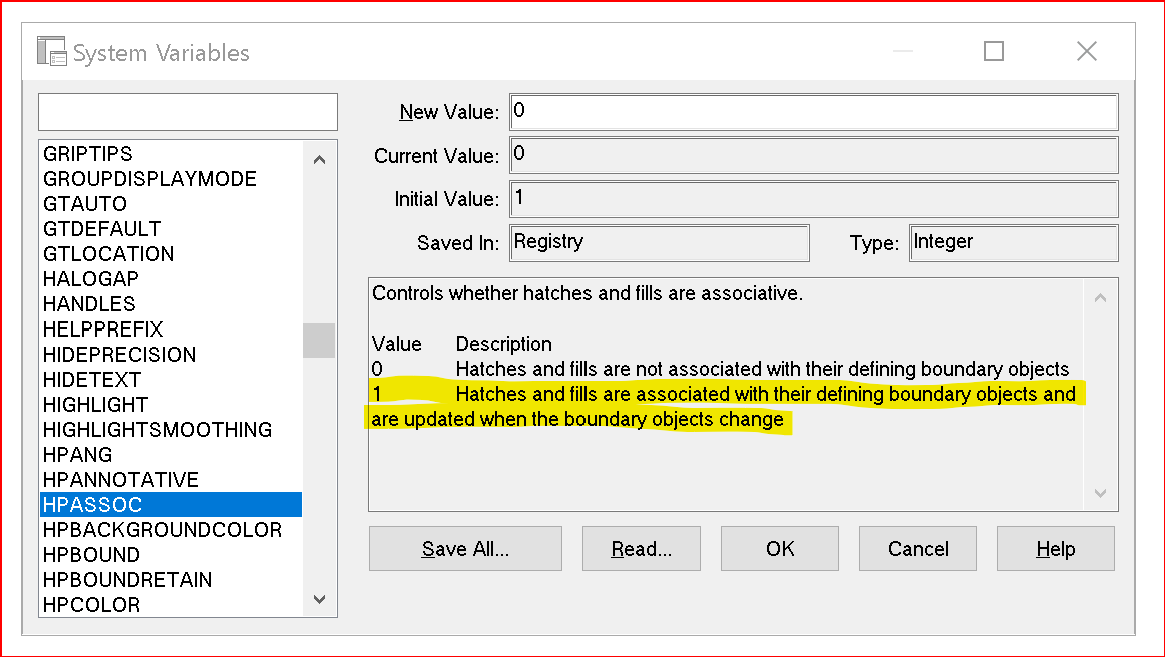

Probably a good idea to edit your default HATCH setting to create ASSOCIATIVE HATCHES too, for the next time.
RESET your HPASSOCIATIVE system variable setting value to   1.   :beer:

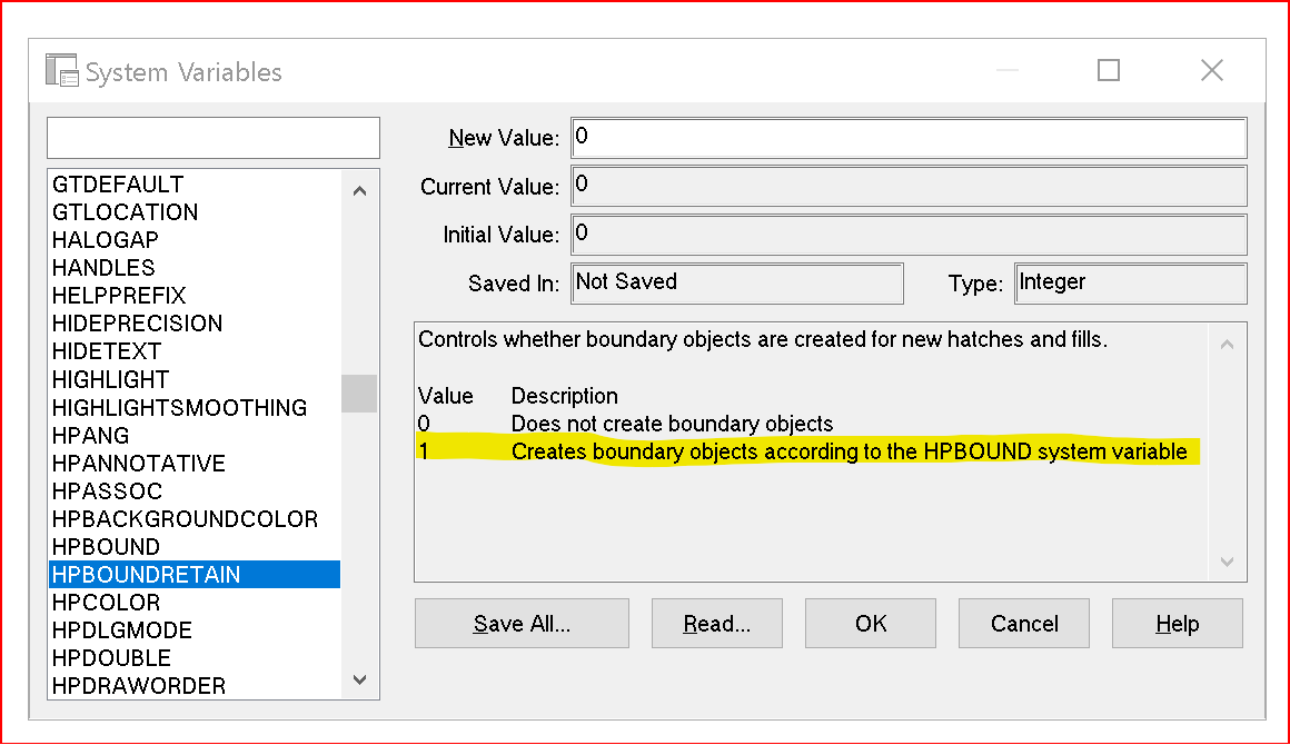

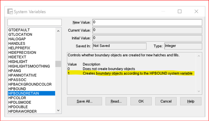

Another variable to tweak would be HPBOUNDRETAIN, you should set it to  1, not the default  0.
Edited by Dadgad
Another variable added
